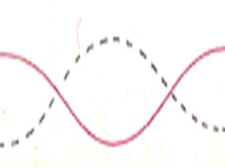

a) Okay, so the Standing Wave has the form of the Picture bellow:
So, 4*(λ/4) = L <=> λ = 0.4 m
v = λ*f
f = 87.0 Hz
___________________________
v = 34.8 m/s
