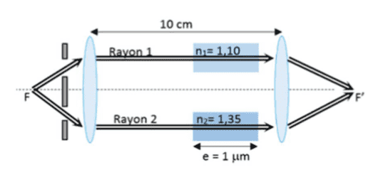

Hi, I need help finding the phase difference between the two rays converging at F'.
I was given this figure, the distance between the lenses is 10cm, the thickness of the lense is 1micrometer and the indexes are on the figure. The light is a laser in which lamda = 500nm.
I tried to write down the two expressions of the two phases of each ray, and I found :
phi1 = (2pi x . 1,1) / 500x10^-9 and phi2 = (2pi x . 1,35) / 500x10^-9.
So i don't understand in this case is x a constant or a variable and how to do I calculate the phase difference of these two rays because when i tried to calculate phi2 - phi1 I found a really weird anwer. And also, is the unit of phase difference rad/m?
And then with the answer, how would I know if it's a constructive or destructive interference?
Thank you all for your help cheers!

Judging from the diagram, you mean that each ray passes through a block of length 1micrometer.
Yes that is correct, but the indexes are different, (i'm not sure if I'm using the correct term but what i mean by index is the number in which the speed of light in a vacuum is divided by to obtain the speed of light in the environment. And the rays are only considered once they have passed the first lens. Thanks for your help.

But i thought that 1 micrometer is the thickness of the lense? I don't see how you can use that for the phase since we have to calculate the phase difference at F'. Or i think I am just not understanding the concept of what a phase is?
My post #3 was to point out that it is not the thickness of the lens. Forget the lenses.
In the diagram, just concentrate on the two blue shaded rectangles. These are where the optical path lengths differ, so are the only relevant part of the apparatus.
Each of these blocks is physically 1μm long, as labelled in the diagram (“e=1μm"). This is the x in your formula.
Because they have different indices, they have different optical path lengths. The optical path length is the physical length multiplied by the index. This is what creates the phase difference.

Oh wow that's amazing, i used x = 1micrometer and i found a multiple of pi. You're the best.
So now that I used it, phi2 - phi1 = pi.
But now determining the interference at F', since the phase shifted of a value of pi, so 180deg or 0deg. If i replace this value, i would get 2 sin (theta) so a doubled amplitude right?

Now that the problem has been solved let me show you the method I originally suggested for your benefit and for the benefit of those who may encounter a similar question. It is based on two simple ideas
1. Every time the traveling plane electromagnetic wave advances by one wavelength, its phase advances by 2π.
2. When light of wavelength λ0 in vacuum travels through a medium of index of refraction ##n##, its wavelength is given by ##\lambda=\lambda_0/n##.
In this problem from point F to F' the two rayons advance by the same phase while in vacuum but by different phases when they go through the 1 μm materials because their wavelengths are no longer equal. The equation that gives the phase advancement when the light travels through thickness ##d## is ##\phi=2\pi \dfrac{d}{\lambda_0/ n}=2\pi \dfrac{nd}{\lambda_0}##.
Rayon 1 advances by ##2\pi \dfrac{1.10\times 10^{-6}}{500\times 10^{-9}}=2\pi(2.2)##.
Rayon 2 advances by ##2\pi \dfrac{1.35\times 10^{-6}}{500\times 10^{-9}}=2\pi(2.7)##.
The phase difference between the two is ##\Delta \phi=2\pi(2.7-2.2)=2\pi(0.5)=\pi.##
This means destructive interference.

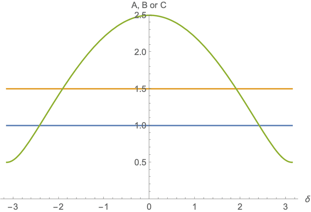

I did some plots and found that the amplitude ##C## of the resultant is not necessarily between ##A## and ##B## Shown below is a plot of the coefficients with ##A = 1##, ##B=1.5## and ##C## as a function of ##\delta## ##(-\pi \leq \delta \leq \pi).## I can see that partial constructive/destructive might be when ##C## is above/below both ##A## and ##B## but there is also the nopersonsland where ##C## falls between the two. What do you think?
kuruman said:
I did some plots and found that the amplitude C of the resultant is not necessarily between A and B
Well, of course not, since they can largely reinforce.
In principle, you could get any amplitude between A+B and |A-B|. So if A>2B you can't get anything less than B.
The trouble with limiting "constructive" to mean totally in phase (and similarly "destructive") is that in practice that will never happen.
