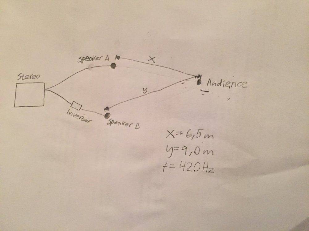

Two similar speakers are connected to a stereo system that emits a signal of frequency đť‘“. However, the signal to speaker B is inverted so that positive voltage becomes negative (but with the same absolute value) and vice versa for negative voltages that become positive. A sound intensity meter shows 80.0 dB at a distance of 1.0 m in front of each of the speakers when only that speaker is turned on. How large will the sound intensity level of the audience be when both speakers are turned on? The sound speed is 340 m / s.

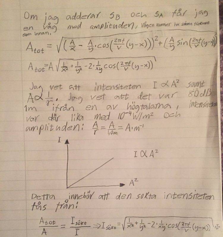

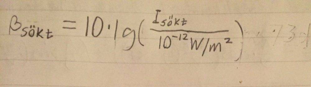

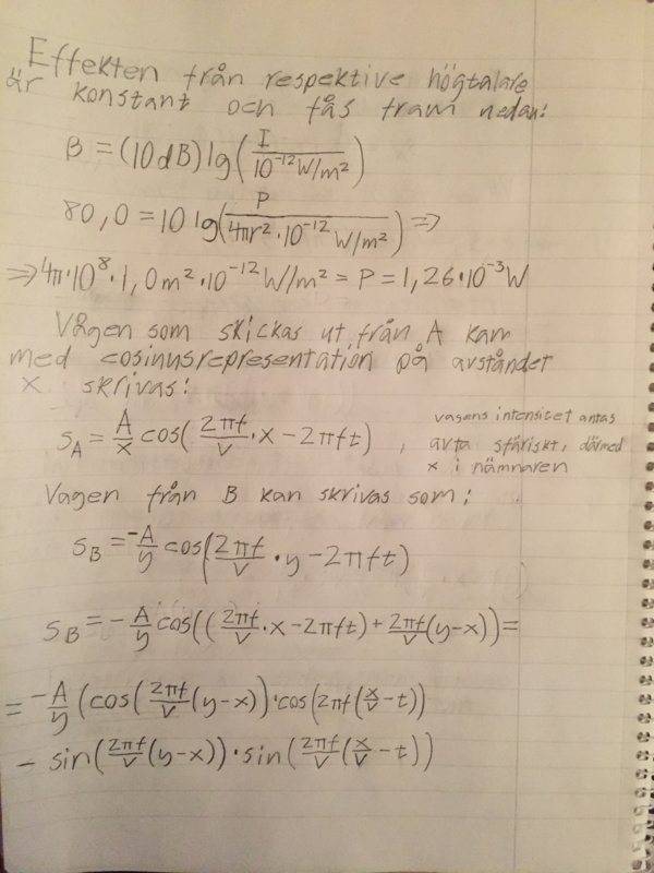

The images below contains a picture of the problem, some values and my try of the problem. Is my solution correct? If not then why?
  • Hand-drawn diagram of two speakers, A and B, fed from a stereo: B's signal passes through an inverter. Paths X from speaker A and Y from speaker B lead to the audience. Values: X = 6.5 m, Y = 9.0 m, f = 420 Hz.

  • Handwritten notes in Swedish on lined paper deriving the combined wave from two speakers: intensity formula B = 10 dB lg(I/10^-12 W/m^2), P = 1.26·10^-3 W, and superposed waves S_A and S_B using cosine and sine identities.
  • Handwritten derivation in Swedish of the combined amplitude of two waves, with formulas for A_tot and I_sökt and a sketch of I proportional to A squared.
  • Handwritten equation: B_sökt = 10 · lg( I_sökt / (10^-12 W/m²) ) · ?3?, with the last factor partly faded and hard to read.
Your work looks good to me overall except near the end. Did you take into account that ##I## is proportional to the square of ##A## when writing the equation at the bottom of the third image?
Oh, wow. Silly me, I even wrote that the intensity was proportional to the square of the amplitude above on that same page. Thanks! I looked through it again now and I can't find anything else that is wrong either.
Everything else looks good to me.
