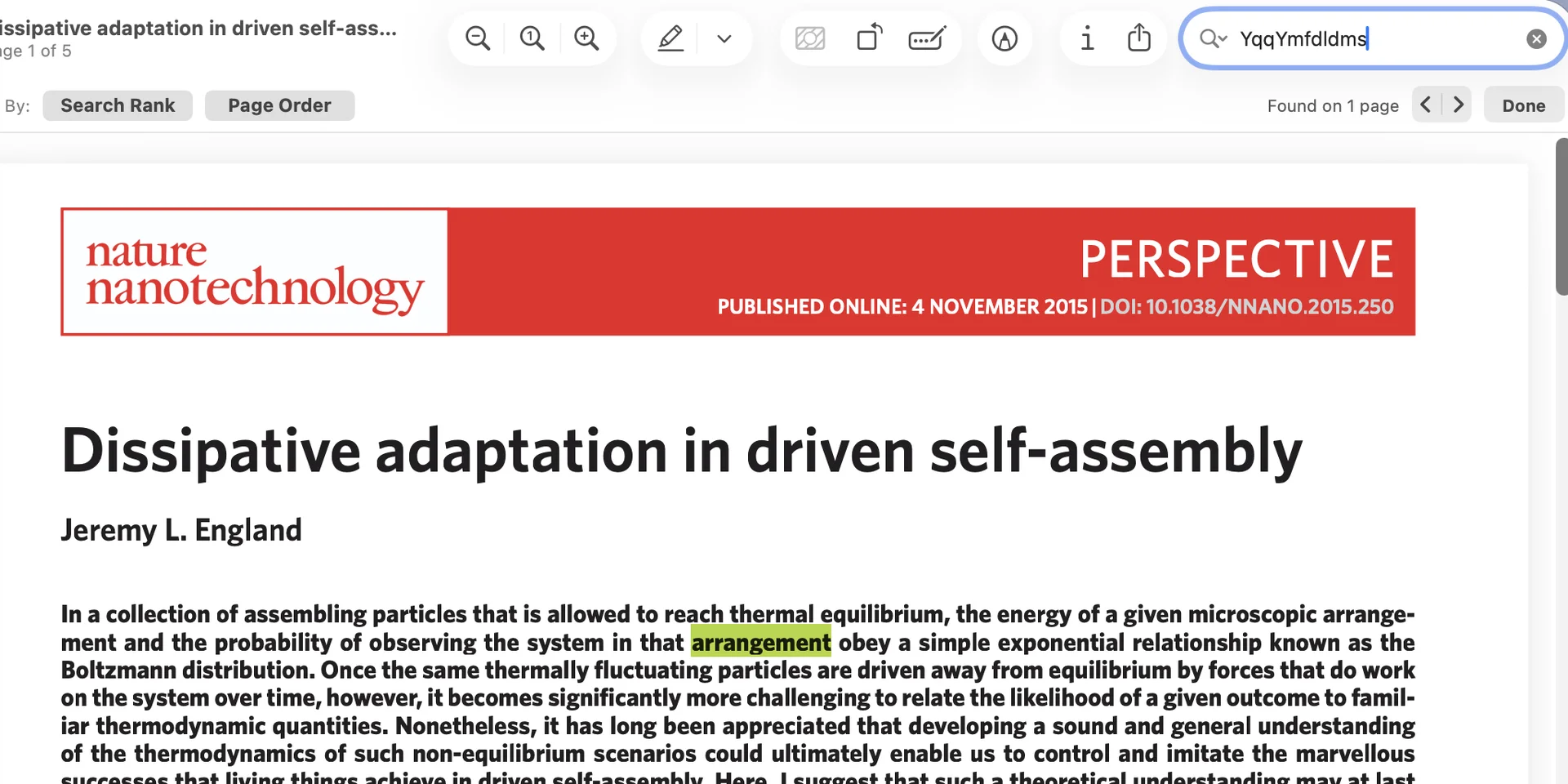

I have a 2024 MacBook Pro (M4 chip) running Tahoe 26.5.2.
When I copy text out of a pdf in Preview version 11 (1113.5.3)the letters copied are shifter to different letters. The letters are changed to different letters. If used in a search in the document, it finds the original word.
Here is an example, copied text in the search field is from the green highlighted text in the pdf.
Screenshot of a PDF in Preview showing the title page of a Nature Nanotechnology perspective, Dissipative adaptation in driven self-assembly, with the word arrangement highlighted and a search field containing a garbled string.
These changes do not happen if the same text is copied from the document on line.
It only seems to happen for me when copying from pdfs from the Nature family on journals.
Very curious.
Interested to hear people's thoughts on this.
Almost certainly how the document was encoded / some flaw there in. Are there any outstanding updates for your pdf reader though? If you open same pdf in a different reader do you get different results? That would help troubleshoot it a bit more.
I've seen docs that look okay but when you select text it reverses the letters.
An example, selecting the word “smart” and you “trams”.

Preview (Apple pdf reader) is up to date.
Opened the same file in PDF expert, which I don't think is up to date of at least new, and got the same behavior.
