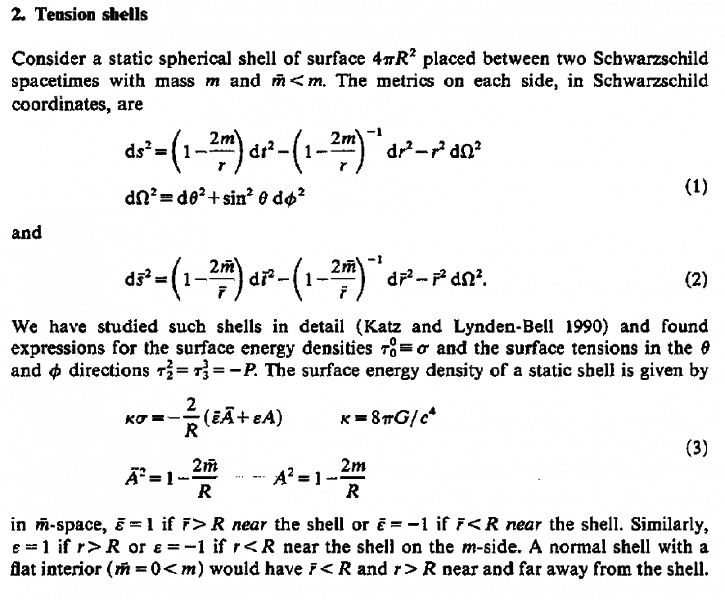

I've been learning the Israel formalism (see original article here) for thin shells. I think I understand the formalism well and how to do the matching given two manifolds (that are solutions of the Einstein's field equations - EFE).
I've been studying several articles that use the matching formalism to construct new solutions of the EFE and I've stumbled on the article: "Tension shells and tension stars" by D. Lynden-Bell and J. Katz (see original article here). The article is only accessible through payment so I'll try to explain my doubt.
The authors consider the following setup: A static spherical shell of surface ##4\pi R^2## placed between two Schwarzschild spacetimes, with mass ##m## and ##\bar{m}<m##. The metrics on each side of the shell, in Schwarzschild coordinates, are
$$ds^{2}=-\left(1-\frac{2\, m}{r}\right)dt^{2}+\left(1-\frac{2\, m}{r}\right)^{-1}dr^{2}+r^{2}d\Omega^{2},$$
where ##d\Omega ^2 =d\theta^2+\sin(\theta)d\varphi^2##, and
$$ds^{2}=-\left(1-\frac{2\, \bar{m}}{\bar{r}}\right)dt^{2}+\left(1-\frac{2\, \bar{m}}{\bar{r}}\right)^{-1}dr^{2}+r^{2}d\Omega^{2}.$$
Following Israel formalism the authors find the following expression for the surface energy density of the shell:
$$8\pi \sigma=-\frac{2}{R}\left(\bar{\epsilon}\bar{A}+\epsilon A \right),$$
where
$$A^2=1-\frac{2\, m}{r}$$
and
$$\bar{A}^2=1-\frac{2\, \bar{m}}{\bar{r}}.$$
As seen from the ##\bar{m}##-side, if ##\bar{\epsilon}=1##: ##\bar{r}>R## near the shell; or ##\bar{\epsilon}=-1##: ##\bar{r}<R## near the shell. Similarly, ##\epsilon=1##: ##r>R## near the shell; or ##\epsilon=-1##: ##r<R## near the shell.
Now the authors claim that in order to have a positive surface energy density ##\bar{\epsilon}=-1##. If they consider that "inside" the shell the spacetime is flat - ##\bar{A}=1## then by considering ##\epsilon=-1## they will have a shell on the other side of the Einstein-Rosen bridge. Now, I understand they argument and I accept it. My problem is, how can they relate the sign of the ##\bar{\epsilon}## and ##\epsilon## with the condition that the Schwarzschild radial coordinate is greater or smaller than the radial coordinate of the shell.
From my calculations their ##\epsilon## variables appear in the expression for the normal to the shell, this is, for example, as seen from the ##m##-side I get:
$$n_\mu = \epsilon (0, u^0),$$
where ##u^0## is the time coordinate of the velocity of a particle comoving (well in this case just chilling out while time passes) with the shell.

The conditions as I understand them are:
(1) On the "unbarred" side of the shell, ##m > 0## and ##\epsilon = -1##, meaning that ##r < R## as the shell is approached from this side.
(2) On the "barred" side, ##\bar{m} = 0## (i.e., spacetime is flat) and ##\bar{\epsilon} = -1##, meaning that ##\bar{r} < R## as the shell is approached from this side.
The barred side makes sense: it looks like a flat Minkowski region inside a spherical shell. However, the unbarred side does not: it looks like a Schwarzschild region *interior* to the shell (because ##r < R##), not exterior to it. So this looks like a shell with two interiors but no exterior (no region with ##r > R##).

I start by apologizing for the very late reply, I had a problem with my computer.
Now, perhaps it's easier for me to just post some images of the article. I hope I'm not breaking any copyright rule since it's only a small part of the article.

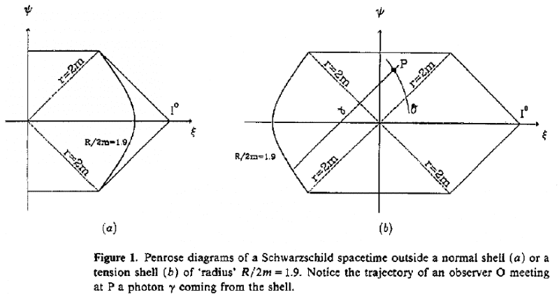

Check the images below with parts of the article:
the next page:
And here are the - mentioned - figures 1 and 2:

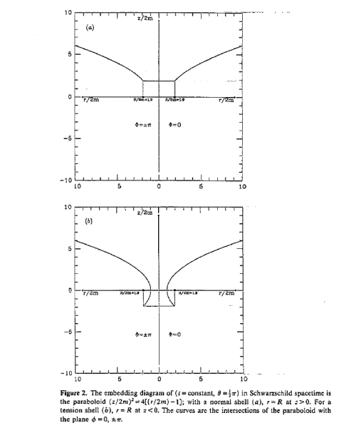

Something still doesn't add up for me. First, in the "normal shell" diagram, there should not be horizons (the lines r = 2m). The spacetime inside the normal shell is flat, so the left side of the Penrose diagram (i.e., the boundary to the left of the shell) should just be a vertical line ##r = 0## between ##i^-## and ##i^+## (i.e., the points at the bottom and top ends of the shell), as in ordinary Minkowski spacetime. So that diagram doesn't make sense.
The "tension shell" diagram doesn't make sense either. The implication appears to be that the shell is now the left boundary of the diagram--i.e., there is no spacetime to the left of the shell. That means the region to the right of the shell, or at least a portion of it, is supposed to be the "inside" of the shell (the barred region) as well as the "outside" (the unbarred region). That seems inconsistent: the barred region is flat (##\bar{m} = 0##) and the unbarred region is curved (##m > 0##). The same region of spacetime can't be both flat and curved.
So ISTM that either the paper is making some kind of error somewhere, or there's still a missing piece that isn't in the parts you've quoted so far.

On the tension shell case, I thought that figure. 1. b) is also incomplete and it is only showing the Schwarzschild spacetime outside the shell. I don't understand your doubt in here, looking at the embedding diagram of the tension shell it seems correct to me, although I still don't see their relation between the sign of the ##\epsilon##s and the comparison with the Schwarzschild radius near the shell.
There's nothing else to quote from the article. The images that I have uploaded are all there is.
Penrose diagrams are not supposed to be incomplete; they are supposed to show the entire spacetime. If there is a region of spacetime "inside" the shell (i.e., to the left of it on the diagram), it should be shown.
However, another reason why I don't think there is such a region is that ##\bar{r} < R## near the shell. On the Penrose diagram, that means the "barred" region should be to the right of the shell, since in that region the radial coordinate is decreasing to the right (i.e., toward the ##r = 2m## lines). The region to the left of the shell, if there were one, would, it seems to me, have to have ##\bar{r} > R##.
It may be "correct" in the sense that it's consistent with the other descriptions in the paper, but I don't think it's consistent in the sense of being a valid solution. The "flat" region (the rectangular box) should not be able to overlap the curved region (the paraboloids), because, once again, the same region of spacetime (or the same portion of a spacelike slice) cannot be both flat and curved.

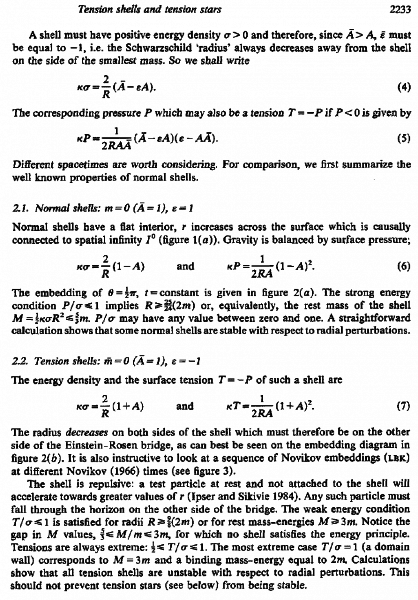

If we suppose for the sake of argument that the equations in the paper do in fact form a valid solution (which, for the reasons I've given, I don't think is the case), then their equation (3) makes this clear. That equation (omitting unit conversion factors) is
\sigma = - \frac{2}{R} \left( \bar{\epsilon} \bar{A} + \epsilon A \right)
We are also given that ##\bar{A} > A##, which follows from ##\bar{m} < m## and the equations for ##\bar{A}## and ##A## in terms of ##\bar{m}## and ##m##. (There is also an unstated assumption that ##\bar{A}## and ##A## are both positive, but that's a standard assumption in these types of scenarios, though the notation is a bit different here.)
Now if ##\sigma > 0## (positive energy density), we must have ##\bar{\epsilon} \bar{A} + \epsilon A < 0##, which implies ##\bar{\epsilon} \bar{A} < - \epsilon A##. Now suppose that ##\bar{\epsilon} = 1##. We then have two possibilities:
(1) If ##\epsilon = 1##, we have ##\bar{A} < - A##, which is impossible since ##\bar{A}## and ##A## are both positive.
(2) If ##\epsilon = -1##, we have ##\bar{A} < A##, which contradicts the given condition that ##\bar{A} > A##.
So if ##\sigma > 0##, ##\bar{\epsilon} = 1## is impossible and we must have ##\bar{\epsilon} = -1##. That gives either ##- \bar{A} < - A## or ##- \bar{A} < A##, depending on whether ##\epsilon = 1## or ##\epsilon = -1##, both of which are obviously true, so both possibilities for ##\epsilon## need to be considered (which they are in the paper).

I understand why ##\bar{\epsilon}=-1## and so on. My problem is the relation between the ##\epsilon##s and the comparison between the radial coordinate near the shell.
Ah, ok. I don't think there's enough information in what you posted for me to see how they derived that, but I'll take another look. I suspect they were viewing it more as a definition than as something that could be derived.

The authors don't explain anything about the formulas on Eq. ##(3)##. They do, however, claim that they have studied in detail tension shells on a previous work but I can't seem to find any link to that work, not even in the journal's website.
In this same article they also find solutions of tension stars (assuming a Schwarzschild star model - constant density) and they find that such stars also must be on the other side of the Einstein-Rosen bridge, so it's somehow consistent with their claim on tension stars.
