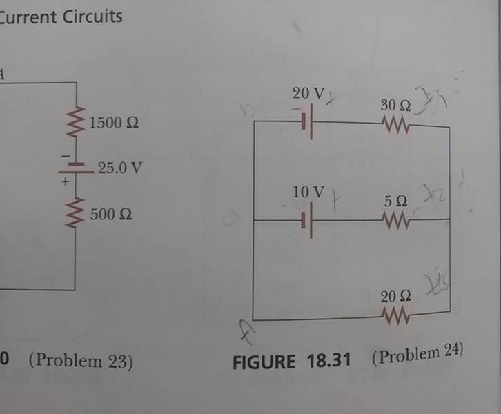

That's probably where my mistake is at, but I3 counterclockwise, I 2 counterclockwise, and I 1 counterclockwise? This is the part I'm a little confused about because I've been learning kirchhoffs rules from a book and khan's academy. They all flow to the closest stronger volt source?
It would be clearer if you specified ##I_1## as to the right or to the left through the 30Ω resistor. Similarly for the other two currents. On your circuit diagram, these directions should be indicated with arrows.
I 1 to the right, I 3 to the right, and i 2 to the left as assumed from my first equation I 1 +I 3=i 2

Note that the equation I1 + I3 = I2 would have also resulted from taking I1 to the left, I3 to the left and I2 to the right.
But, OK. We now have definite directions for the currents: I1 to the right, I3 to the right, and I2 to the left.
Your junction equation I1 + I3 = I2 is correct.

It is important to note that you generally will not know ahead of time the correct directions for the currents. That is part of what you will determine when solving the problem. But, the nice thing is that you can assume any direction you want for any of the currents. If your initial choice of direction for a current turns out to be wrong, then you will get a negative answer for that current. The negative sign indicates that the current is actually in the opposite direction from what you initially assumed.
So, for example, if you end up getting I2 = -4 A, then the current I2 will be 4 A in a direction opposite of what you initially chose when setting up your equations.
But it is essential to make an initial choice for the direction of each current and stick with that choice while setting up the signs in your equations.
