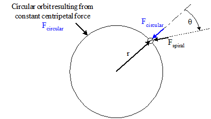

As you'll know, the driving force for a circular movement is a centripetal force. But wat is the dynamics for a spiral movement, i.e. an increasing circular movement? And how can I produce it, let's say for a little spherical object, in real life?
I guess there will also be a force parallel to the velocity. I don't know how to create a force that is allways parallel to the velocity.​

Maybe try thinking about what would happen if the "centripetal" force happened to not actually point towards the center, but instead was directed at some constant angle to the radius vector.

So, there will be a component parallel to the velocity and the radius of the circle would grow over time. How could I, practically create something like that?

Regardless of how an object is moving, its acceleration (and hence the force acting on it) will be perpendicular to the velocity unless the speed is increasing or decreasing. This follows directly from differentiating ##v^2 = \vec v^2## with respect to time.
Now, this means that in an accelerated circular motion (i.e., increasing speed) there is also a force component parallel to the velocity, but this is true regardless of the shape of the motion.

So a "practical" demonstration might be to have a charged particle moving perpendicularly to an increasing or decreasing magnetic field, hence continuously changing the centripetal force.
Yes, and you would not need it to vary over time. It could be a field which is strongest at some central axis then falling off at greater radii. Depending on the injection parameters the particle could spiral in or out.
