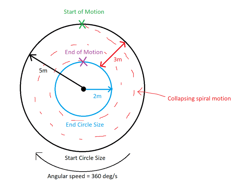

Hello,
I am currently working on a computer program to move on object undergoing circular motion in a spiral of decreasing radius. I hope this is illustrated clearly below (forgive me but it is a sketch and thus not precise in scale):
The scenario is as follows:
1. The object starts angular motion at the green "X"
2. The object starts orbiting at an angular speed of 360 deg/s
3. The object immediately undergoes the collapsing spiral when it starts moving from the green "X"
4. The spiral decreases at a linear (constant) rate
5. The object reaches the end of motion at the purple "X"
From this scenario, I can see that the linear distance covered is 3m. I also know that the angular speed (or velocity) is constantly changing during the spiral, since the radius is changing. The challenge I have is to control the exact number of spirals that occur between the green "X" and purple "X".
I have tried to tackle this challenge in multiple ways, but none of them are precise and I can never get an exact number of spirals - if I am aiming for say 2 spirals, sometimes it will overshoot and sometimes it will undershoot. I think my problem is that I am cobbling together code without understanding the underlying math, so I would really appreciate if anyone can advise how to achieve this in a precise and reliable way that is mathematically sound. A few of my initial thoughts are:
1. The linear distance must come into the equation somehow
2. I know what the start and end angular velocities are since I know the radii of the circles - this may be of some use
Any help would be greatly appreciated.
Thank you
Well, if you know the angular velocity boils down to one revolution per second and you want ##n## revolutions then you need ##n## seconds, right? So if the difference in radii is ##d## then you need an inward radial speed of ##d/n##. Unless there are other constraints on the path?

What are you holding constant as you decrease the radius of the spiraling object?
Are you holding angular momentum constant? Are you holding rotation rate constant? Are you holding velocity constant? Or are you holding something else constant?
I believe I made a mistake in my phrasing in the original post. It is the linear velocity that changes with radius (since v = wr). The angular velocity is at a constant 360 deg/s. I don't believe there are other constraints on the path. Do you know how to adjust the inward radial speed given this new information?
That is an excellent question! The angular momentum is being held constant and I have no control over it. I can however control the speed at which the object moves in towards the centre (whilst simultaneously orbiting at the constant angular momentum).

Okay so the angular speed is what is held constant, i.e. the object rotates at a fixed 360 deg/s.
Oh, then all you have to do is "reel in the string" at an even rate so that it takes time enough to hit the desired number of rotations, surely?
jbriggs444 said:
Oh, then all you have to do is reel in the string at an even rate so that it takes time enough to hit the desired whole number of rotations, surely?
But how exactly do I find this rate? If I follow Ibix's suggestion, i.e. speed = difference in radii/number of turns, this does not produce the correct number of spirals. For example if I try 2 spirals, it will hit the smaller radius at approximately 1.7 spirals rather than 2. I also assume this loses precision as the number of spirals increases but that may not be the case.
If you want two rotations, then you need a reel-in rate of 1.5 meters per second. Over the course of two seconds, you will have two complete rotations around the center. What is the problem?
At a wild guess, you have decided to add up incremental diagonal arc length and divide by [current] altitude to get a cobbled-up angular rotation rate. You are then integrating that angular rotation rate to find that you've covered two complete rotations in only 1.7 seconds.
That would ignore the fact that 2 complete rotations take exactly 2 seconds given a 360 degree per second fixed rotation rate.
I understand your first point but the problem is that I am not seeing what is expected, i.e. by setting the reel-rate it does not complete the expected 2 full spirals.
I don't believe I am cobbling together the angular rotation rate, that is fixed at 360 deg/s. And I am not integrating anything, I am linearly interpolating the radius whilst the object moves, and it literally hits the smaller radius significantly before 2 full turns.
Perhaps there is something else going on that I need to investigate, I will do a careful inspection and hopefully report back soon. I really appreciate the help by the way so thank you for persisting with me.
