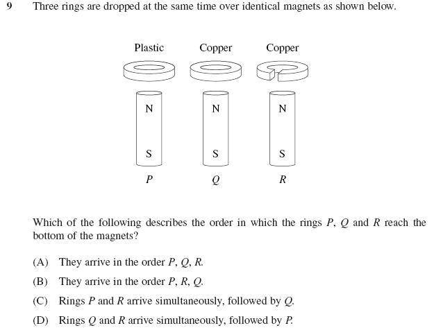

What is the answer to this question(see attachment) ?
i thought the answer was (B) but it is (C)

anybody know why
Answer C is correct-amundo. What retards Q? Why does that same effect not retard R?

jubba said:
anybody know why
What happens when a magnet goes through a closed conductor?
Can current flow through plastic?
can current flow through an open circuit?
As the closed loop conductor slides down the magnet, it generates a current around the loop, so gravity is doing work to produce a current, which takes up some of the work gravity uses to pull the ring down.

i know that the open loop won't have as high a current as the closed loop of copper but should it still have some eddy currents. Afterall it is still a piece of metal experiencing a change in flux through it.
Thats why i thought it should be
p,r,q
p,r,q
Nope. The eddy current would need to flow around the enclosed surface with the changing flux. Break that outside path, and there is no total eddy current generating an opposing flux and force.
