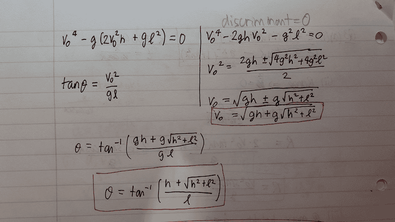

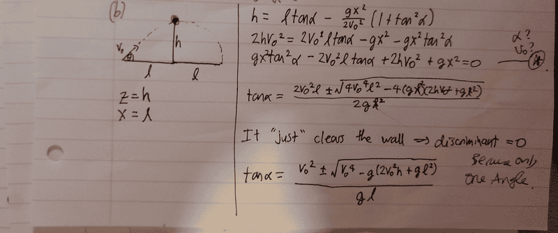

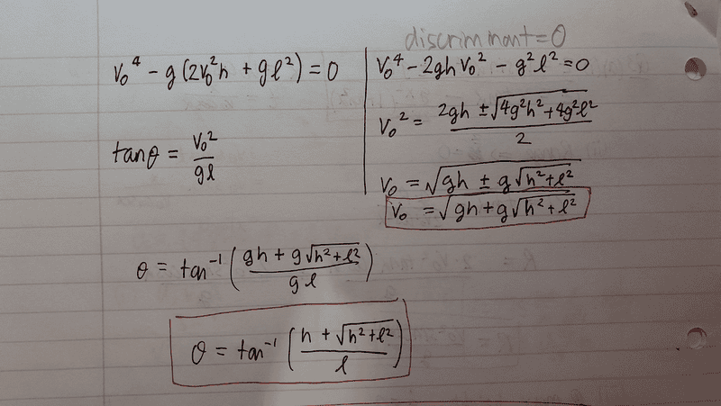

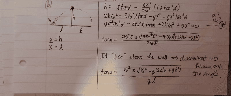

I have attached my solution using my professor's way below.
Note that the first equation I wrote down is simply the trajectory of the ball, with time "t" eliminated.
Handwritten derivation for a projectile problem: diagram of a ball launched at angle alpha with speed v0 over a wall of height h at distance l, followed by trajectory equation h = l tan(alpha) minus g x squared over 2 v0 squared times (1 + tan squared alpha), and the quadratic in tan(alpha) using a zero discriminant.
Handwritten derivation on lined paper: v0^4 - g(2v0^2 h + g l^2) = 0, tan θ = v0^2/(gl), quadratic solved for v0 with discriminant = 0 noted, and boxed result θ = tan^-1((h + sqrt(h^2 + l^2))/l).
However, something concerns me. This answer does not match the multiple choice answers in the book. Furthermore, I did the problem another way and I got the multiple choice option (d). Also - another source: https://math.stackexchange.com/questions/3668451/derivation-check-of-a-parabolic-trajectory-problem
On the other hand, I cannot see how my professor's method is wrong. Is it possible that both answers are correct?
This is a long question, so thanks in advance for reading it!
I don't understand your handwritten solution. You say that the discriminant must be zero. What exactly are you setting equal to zero in your solution?
Sorry if it's unclear, on the last line of the first page, I have just simplified the 3rd line from the bottom on the first page. (You can just ignore the 2nd last line on the first page I guess)
I set the discriminant equal to zero on the second page, right hand side.

First, the written solution looks wrong to me. Note that, by symmetry, the top of the wall must be the highest point. That should make things a lot simpler.
Second, one of the multiple choice is right, acccording to my solution.
If the justification for setting the discriminant equal to zero is that there be "only one angle" as you say on the first, then you must set the discriminant of the quadratic for the tangent equal to zero. On the first page you show that the tangent is double valued.

If the top of the wall is the highest point, then the discriminant is zero, no? Because it "just" clears the wall. Which means that there is only one solution. Can you elaborate more on why the written solution is wrong?
I didn't look at the solution in detail. I meant it was wrong because it gave the wrong answer!
I didn't do it your way. It looks too complicated for this problem.

Why set the discriminant to zero? Which @kuruman already asked!

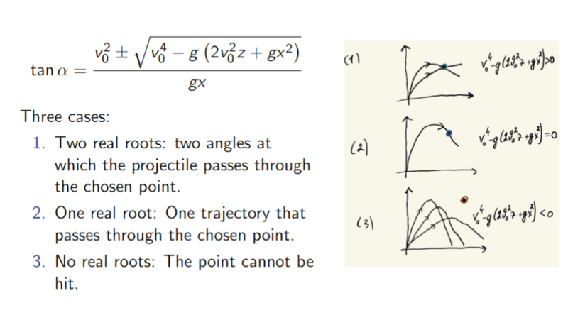

Three-panel sketch of projectile trajectories for cases of the tan α formula's discriminant: panel 1 shows two arcs through a point with the discriminant greater than zero, panel 2 shows one arc touching the point with the discriminant equal to zero, panel 3 shows the point lying above all arcs with the discriminant less than zero.
Basically, if there are two roots, then neither of them will be the "high point" of their trajectory. This can be seen from the 1st diagram on the right.
However, if there is only one root (i.e. discriminant = 0), the ball "barely" hits the wall, and this point will also be the peak height of the ball. (I believe the 2nd diagram in the picture is misleading because if it is true then there is another angle that can hit it). Do you agree with this?
But, that's a different problem. You've minimised the velocity to hit the top of the wall. That's not what this problem asks you to do. With your solution the ball will not reach your friend!

Interesting, I just rechecked the example the professor did, and indeed, that question did ask for the "minimum speed"! Here was the exact wording:
Text problem: A ball is projected with speed v in a plane perpendicular to a wall of height h and a distance h away. What is the minimum initial speed required so that the ball may pass over the wall?
So seems like they are different problems :O.
However, I am not really convinced. I believe you are correct, but I don't get it. How am I minimising the velocity? I suppose it's because the ball "just" hits the wall? But if it "just" hits the wall and there is only one root (discriminant = 0), then the ball is at its peak at the top of the wall, correct?
So if it has travelled a distance "l" to get there, and the top is the peak, then why wouldn't it reach my friend if the ball just has to travel "l" more?
I agree with @PeroK that setting the discriminant equal to zero addresses a different problem. For one thing you found that the discriminant method yields a projection angle ##\tan\theta =\dfrac{v_0^2}{gl}.## How can that projection angle guarantee that the projectile just clears the height ##h## without being dependent on ##h##?

I know this problem and it is a somewhat delicate argument. With a typical velocity there are two solutions: one where the projectile peaks before the wall (and clears the wall on the way down); and, one where the ball clears the wall while still on the way up. The minimum velocity coincides with the case where it clears the wall on the way down, but there is no second solution. The reason is that if, for a certain ##v##, you could clear the wall on the way up, you could certainly clear the wall with a lower velocity and ##v## cannot be the minimum.
That's why, for this problem, you are looking for ##v_0## where there is one and only one solution for ##\alpha##.

AH, okay. My misconceptions are clear now. It does make sense that if the ball can "just" clear the wall on the way up, there must exist a second solution. So the diagrams I posted before were actually correct. Just one more thing nagging me:
This is equivalent to saying that the minimum velocity happens when the discriminant is zero. I am still a little puzzled over this.

No. If you clear the wall on the way up, then you can reduce the velocity, increase the angle and still clear the wall.
If the discriminant is non-zero, then there is a second solution for that ##v_0##. Two solutions imply you can find a solution for a smaller ##v_0## at some intermediate angle.
I assume that's your professor's argument. It's somewhat delicate, as I said before.
