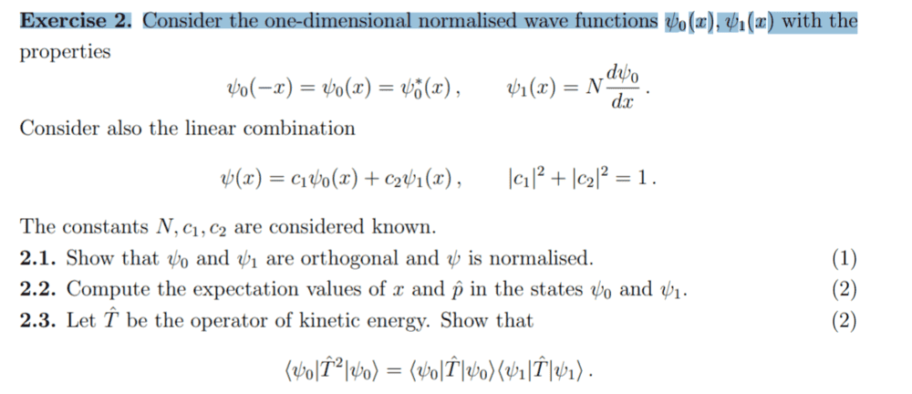

For question 2.2:
0|p|Ψ0> = ∫Ψ0 -iħ d/dx(Ψ0) =M
Using Integration by parts i get:
M = -Ψ0 iħ d/dx(Ψ0) (assuming hilbert space)
Implying the expectation values for momentum are zero , however i get all the expectation values are zero for x and momentum in both states which makes no sense :(

I don't know whether that's correct for this question, as I haven't checked; but, why do you think it makes no sense?
Because everything being zero normally means I am wrong.

I worked out 2.2 abit and also I got that the expectation values for position and momentum for state ##\psi_0## are zero. And I think the same hold for state ##\psi_1##. It is because we always get a product of an odd and an even function in the integrals (since ##\psi_0## is even, ##\psi_0'## is odd ,##\psi_0''## is even and x is odd). So at the very end we get integrals of an odd function which gives zero.
