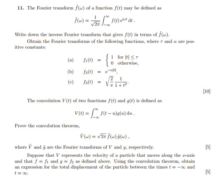

Part(a)/(b)/(c): Fourier transform the following:
Part(d): Prove the convolution theorem
Part (e): Find total displacement

That's some nice work on parts a to c. at the end of part a, it should be ##\tau## (not ##t##), but I'm guessing that is just a miss-type. For part e, there is a mistake in this equation:
[tex]V_{(ω)} = \sqrt{2\pi} F_{(ω)}G_{(ω)} = \frac {2}{\pi} \frac {a sin (ωT)}{a^2 + ω^2}[/tex]
there should be another ##\omega## from ##f_1## (which you have got in part a). And it looks like you've missed out the ##\sqrt{2\pi}## which is on the left hand side of the equation.
Also, there is a simpler way to do part e. You don't need to do the inverse Fourier transform. hint: you have got ##\tilde{V}(\omega )## and you want
[tex]\int_{-\infty}^{\infty}V(t) dt[/tex]
So, thinking about the definition of the Fourier transform, what is the easiest way to get this?

[tex]\tilde{V}(ω) = \int_{-\infty}^{\infty} V_{(t)} e^{iωt} dt[/tex]
I've been thinking of a way to 'remove' the exp[iωt] from the integral and everything would be perfect. The only way is if ω = 0. But if ω = 0, LHS = 0..
yes, use ##\omega=0##. The left hand side is not zero, it is ##\tilde{V}(0)## this isn't zero. Even if it was zero, that would still be the correct answer, since the right hand side is exactly what you are looking for.

The 0 comes about from the sin (ωT) function and part (a) looks right to me..
you have got the correct answer to part (a), but part (a) evaluated at ##\omega=0## is not equal to zero.
edit: you have
[tex]\sqrt{\frac{2}{\pi}} \frac {sin (ω\tau)}{ω}[/tex]
but this is not zero for ##\omega=0##
