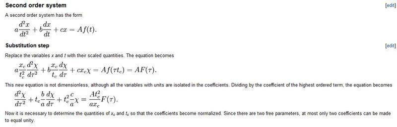

Please check the image, I got it from wikipedia which is similar to the problem i am trying to solve, just a quick question, there's a line on it that says "Since there are two free parameters, at most only two coefficients can be made to equal unity.", i want to know what are the two free parameters, and how do they determine it? This is something that's mentioned in my textbook as well which I am confused of. Thanks

The free parameters are [tex]x_c, t_c[/tex] that were introduced by defining
[tex]x = x_c \chi ,~ t = t_c \tau.[/tex]
The idea is that you can simplify the form of the equation by choosing [tex]x_c, t_c[/tex] in terms of [tex]a,b,c,A[/tex].
