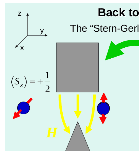

See slides 3 and 22 in this presentation:
https://tsapps.nist.gov/publication/get_pdf.cfm?pub_id=32601
In slide 3 they ask the question: If a spin +X electron beam enters a Stern-Gerlach magnet and forks into two beams with spins +Z and -Z, what happened to the initial angular momentum?
On slide 22 they provide an answer:
Once the linear momentum for the two spin components is split, the transverse angular momentum is “released” to do work on the magnet system.
The quantum equivalent of a card trick. If a card “vanishes” magically from one deck,
it must reappear somewhere else. No mechanism for the transfer of angular momentum
need be invoked!
So according to them, it's a sort of "spooky action at a distance"? 😱🤔
Edit: My classical lizard brain insists on "invoking a mechanism". So it's trying to argue that: The electron changing spin state is like a little armature producing a change in flux. This produces a back-EMF in the Stern-Gerlach magnet (if it's an electromagnet) or a tiny demagnetization (if it's a permanent magnet). In the latter case, an electron somewhere in the magnet should change spin. But OTOH, spooky action at a distance is a lot cooler, so there's that.

Maybe I am missing the trick here, but doesn't the magnetic field exert a torque? (so no conservation of angular momentum). Anyway I think this is enoughly different from the Einstein–De Haas experiment so maybe make another thread for this?
The magnetic torque on the input electron's dipole would be around the axis of propagation (y in the figure), no? Whereas the input spin that "disappears" during the transit is directed away from the page (X)?
Diagram of a Stern-Gerlach setup with axes x, y, z, a gray box labeled H with an arrow to a magnet, a spin arrow labeled <S_x> = +1/2, and blue spheres with red spin arrows.
Diagram of a spinning sphere with a long green vertical arrow through it and dashed circular arrows showing rotation, with a black arrow tilted from the sphere, illustrating a precessing top.
Oh right! but I still do not get what is the solution hinted here. Isn't it just that we shouldn't think of the electron as a top perfectly pointing in the ##x## direction, but more like a precessing top with some projection in the ##x## direction (see image)?
