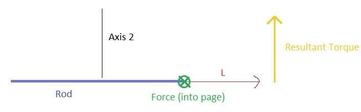

Hey guys,
If I have a uniform rod rotating about its longitudinal axis of symmetry in space it will have an angular momentum vector that is colinear to this axis. If I now apply a force directly perpendicular to this (as shown in attachment) it will induce a torque that is perpendicular to the angular momentum vector. The centre of mass of the object must accelerate in the direction of the applied force and the torque will cause a change in angular momentum.
My question is will this torque just cause this rod to kick up or down, i.e. the angular momentum vector follows the direction of the torque vector and/or will the rod also attempt to rotate about axis 2 in the diagram? If it does rotate about axis 2, where does the torque come from to change the perpendicular angular momentum vector.
Diagram of a horizontal rod with a vertical dashed Axis 2 drawn through it, a green circled cross marking a force into the page at the right end, a red arrow labelled L from that point, and a yellow upward arrow labelled Resultant Torque.
I'm assuming you mean the applied force F is impulsive. Let the initial angular momentum be L1, pointing to the right. The torque resulting from F will cause a change in angular momentum, adding a vertical component ΔL. The new total angular momentum will be the vector sum L2 = L1 + ΔL. As a result the rod is no longer rotating about its axis of symmetry. At the instant the force was applied, the rod was pointing directly to the right. It will not suddenly change direction, but rather wobble (precess) about the direction of L2.
