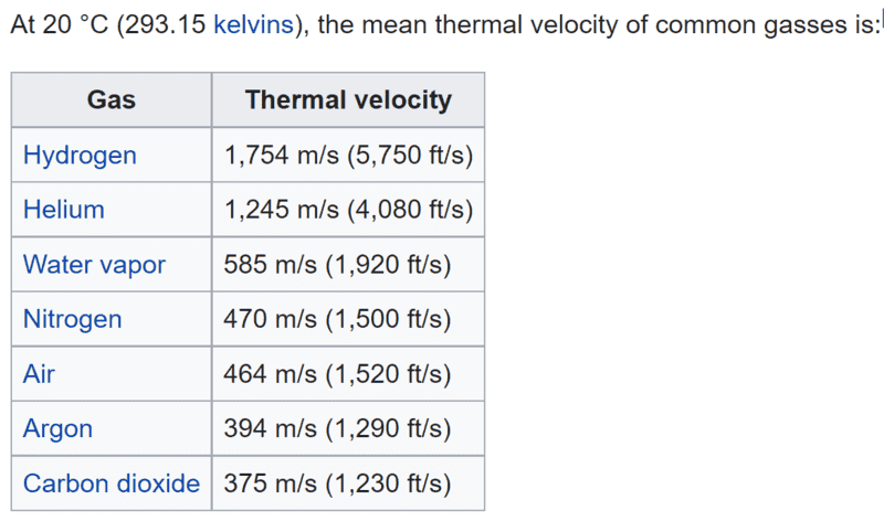

Look it up on Wikipedia https://en.wikipedia.org/wiki/Thermal_velocity
The key word is mean.
Now compare that to the speed of sound at sea level and 20 C ... 343 m/s.
Edit: Don't forget that the mean free path is of the order of 100 nm. Pretty short. So do not imagine the molecules traveling like a wind.
