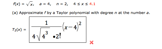

Here is the question:
I don't quite know what I did wrong. My method is below.
f(x)=√x
f'(x)=[itex]\frac{1}{2(x)^{1/2}}[/itex]
f''(x)=[itex]\frac{-1}{(2)(2)(x^{3/2}}[/itex]
a=4
f(a)=2
f'(a)=1/4
f''(a)=[itex]\frac{-1}{4(4^{3})^{1/2}}[/itex]
so wouldn't the second taylor polynomial be what I put in the answer field above? Thanks.

What you have is the degree 2 term (almost). What's the sign?
Include the constant term & the linear term.

Oh, so if it asks for T[itex]_{2}[/itex] it also wants the T[itex]_{1}[/itex] and the constant term as well?
Also, I see now that I somehow dropped a negative sign. Thanks!
EDIT: I just tried it and it's correct, so I answered my own question. But thanks again!
