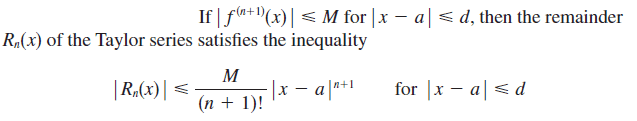

Using Taylor Inequality:
##a=1, d=2## and ##f^{4} (x)=\frac{24}{(1+x)^5}##
I need to find M that satisfies ##|f^4 (x)| \leq M##
From ##|x-1| \leq 2 \rightarrow 0 \leq x+1 \leq 4## , then ##0 \leq (x+1)^5 \leq 4^5##
Putting the boundary of ##(1+x)^5## to ##f^{4} (x)##, there is no upper boundary of ##f^{4} (x)## which does not make sense. And actually ##x+1## can not be zero because ##f^{4} (x)## would be undefined so my approach is certainly wrong.
How to find M? Thanks

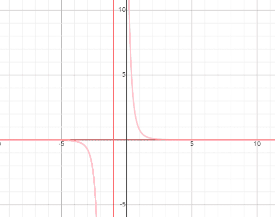

I draw graph of ##\frac{24}{(1+x)^5}##
It is monotonically decreasing in interval ##-1<x<3## and the range will be ##(\frac{3}{128}, \infty )##

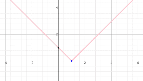

I also draw the graph of ##|x-1|##
But sorry I don't understand how to find the interval where ##|x-1| \le |x'-1|##
When trying to bound the error of the partial series at a point ##x'##, it is only necessary to look at the interval of points ##x## that are at least as close to the 1 as ##x'## is. That is for x in the interval [1-|x'-1|, 1+|x'-1|].

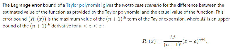

https://brilliant.org/wiki/taylor-series-error-bounds/
This is part of what is in there:
g
and also
At first, I thought ##x## in ##f^{n+1} (x)## is exactly the same as ##x## in ##|x-a| \le d## but in that link, it is written as ##f^{n+1} (z)## instead where ##a<z<x## so I thought ##a## will always be the lower boundary of ##z##, that's why I only checked the value bigger than 1.
