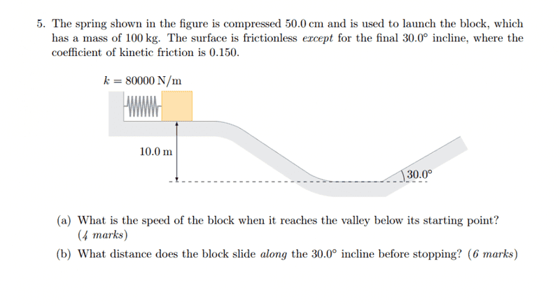

What distance does the block slide?

JiJiasd
m*v^2 / 2 and k*x^2 / 2 and 0,5*m*v^2
[/B]
in task a I got correct answer there v = 20 m/s
in task b I got wrong answer I got the distance = 0,76 m but I should be 32 m
here is my answer :
0,5*m*(sin(30)*v) - mu * m*g*cos(30) = m*g*h
h=0,38 m
sin (30) = h/L there L is the distance of the block when it goes up
L= h/sin(30) = 0,76
What I do wrong in task b ?
Thanks
JiJiasd said:
0,5*m*(sin(30)*v)
sin(30)v should be squared
I seem to get the answer on the second one to be 35.4012435624
JiJiasd said:
mu * m*g*cos(30)
Shouldnt this be mu*(m*g*cos(30))*h/cos(30)=mu*m*g*h?
I think so...
What equation you did use ? thanks
I tried with 0,5*m*(sin(30)*v)^2 - mu * m*g*cos(30) = m*g*h
but it does not give me the correct answer
thanks
I think so...
Now I tried 0,5*m*(sin(30)*v)^2 - mu * m*g*cos(30) *h/sin(30) = m*g*h
but not working
I used a kinematics equation
