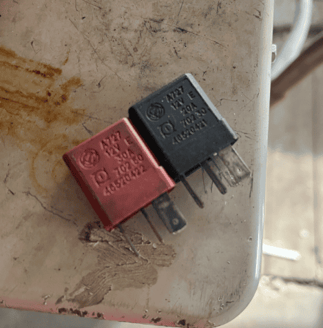

Hi,
Could someone explain to me what amps mean on the automotive relay? Here is the picture of my 30 and 20-amp relays.
Alfa romeo junior said:
Hi,
It's rating for what current the relay contacts can handle safely and continuously. If you had a car headlight that needed 25A in normal operation, you would pick the 30A relay to control it, not the 20A.
Thanks, nsaspook for the explanation. Is that current between contacts 85 and 86, or between 87 and 30?
Yes for 87 and 30. If you use a relay like this, the wiring for those contacts needs a fuse (at the electrical power source or battery) selected to protect the wiring from overloading or short circuits.
Thanksss. Now I understood 100%.
