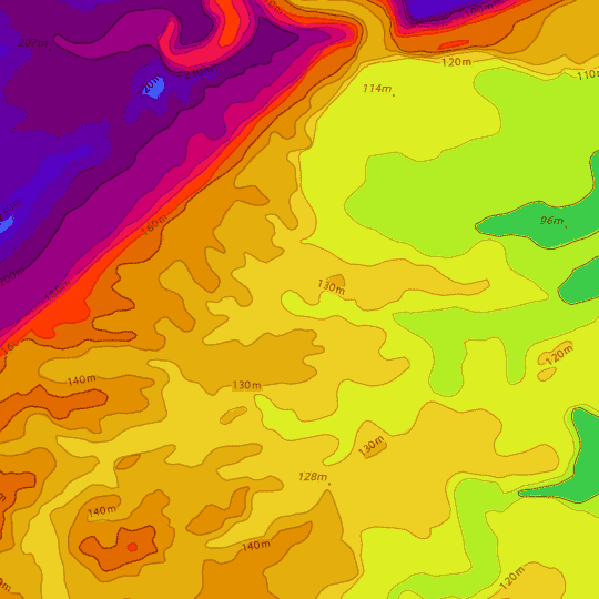

I'm trying to make a physical 3D map of this landscape.
These isolated curves (red) have no altitude on them, so it's up to me to interpret.
How do I know if these are hills or dips?
Can I gather from the rising landscape (marked in magenta) that these are probably hills?
Can I be sure?
Huh. I don't see how you COULD know. It certainly seems likely that they are above the surrounding territory, but that's not a given. It would be perfectly correct to draw the landscape that way if they were dips.

hutchphd said:
According to this source
http://geokov.com/Education/mountain-pass-cliff.aspxIf it is a depression it should have tick marks on the low side. I do remember seeing these on charts. The mountains have no tick marks.
Those cartographers are careful folks.
Thank the heck out of you! Of course!
(Alas, these are digital maps from Toporama. I'm not sure if they're actually showing that symbol. And it's very difficult to verify.)Now that I think about it, depressions are a comparatively rare artifact - especially if not water-filled or at least marshy. 99.9% of small, closed-contour land features are going to be bumps.

I checked a chart online and it appears that depressions in the local topography are treated the same underwater. It's been a while since I did any cartography but think about it this way. If there was no water, where would you start creating tick marks? Certainly not at the 'shoreline' that doesn't exist.
https://www.mindat.org/glossary/depression_contour
A closed contour, inside of which the ground or geologic structure is at a lower elevation than that outside, and distinguished on a map from other contour lines by hachures marked on the downslope or downdip side.

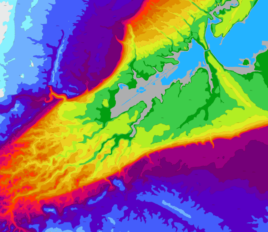

A bit of clarifying colour banding helps clear it up.
I'm glad I took the time to colour the whole thing. I would have been hopelessly lost pretty quickly if I hadn't.

Closed contours that represent depressions have tick marks on the downhill side. This is only true of closed contours. You can see such features on karst features such as sinkholes. Being a caver, I often peruse topo maps online for such features to find caves. You can find many such features on topo maps of N. Florida just south of Tallahassee where there are many sinks.
