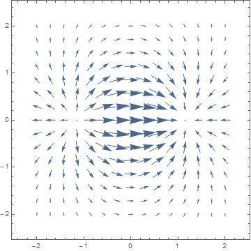

Isaac0427 said:
Ok, can someone explain a source to me.
This vector field has one point source and one point sink. Can you visually spot them. The divergence is zero everywhere except at two points. At the source point it is positive and at the sink point it is negative.
