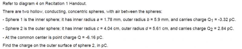

Last line -- When it says find the charge, does it mean find the net charge or...? Can you please restate the question? Thanks
The question is: " Find the charge on the outer surface of sphere 2. "
