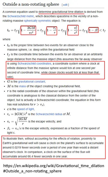

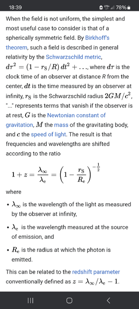

A gravitational redshift can also equivalently be interpreted as gravitational time dilation at the source of the radiation:[8][2] if two oscillators (attached to transmitters producing electromagnetic radiation) are operating at different gravitational potentials, the oscillator at the higher gravitational potential (farther from the attracting body) will tick faster; that is, when observed from the same location, it will have a higher measured frequency than the oscillator at the lower gravitational potential (closer to the attracting body).
https://en.wikipedia.org/wiki/Gravitational_redshift#Spherically_symmetric_gravitational_field
The Wiki page fails to note that Birkhoff's theorem applies to a vacuum spacetime (although the Birkhoff's theorem page it links to does so). Otherwise that seems fine.
Is there any reason you are quoting large chunks of text without any questions?

So this is still related to your questions about cosmological spacetimes, which are not static, not vacuum, and where you are trying to compare clock rates of timelike separated clocks? In that case I don't see why you're quoting results that apply to spacelike-separated clocks in static vacuum spacetime.

In a static spacetime, like Schwarzschild, the redshift is related to a potential. And that potential is related to time dilation.
But in a non-static spacetime, like FLRW, there is no potential. So the connection is broken. Two comoving observers, neither of which are time dilated in FLRW coordinates, will still be redshifted wrt each other.
