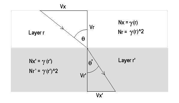

Mathpages does not explore the non isotropic model in any detail and I was curious what that would look like, starting with this simplified model with parallel thin layers:
The incident ray passes from layer r to layer r' with the refractive index and velocity of the ray broken down into orthogonal components. Here ##\gamma(r)## and ##\gamma(r')## mean ##1/\sqrt{1-2m/r}## and ##1/\sqrt{1-2m/r'}## respectively. Everything is measured in the coordinates of the observer at infinity. Layer r' is lower in the gravitational field than layer r and has a higher refractive index. By simple trigonometry it is easy to determine that:
[tex]\frac{\tan(\theta)}{\tan(\theta')} = \frac{V_x/V_r}{V_x'/V_r'} = \frac{\gamma(r)}{\gamma(r')} = \frac{N_x}{N_x'}[/tex]
This is an interesting, yet still surprisingly simple version of Snell's law.
Mathpages mentions that the optical model does not take account of the additional curvature due to the curvature of spacetime. If we take the above simplified model with flat parallel layers and adapt it to the form of concentric spherical shells, it seems almost certain that their will be additional curvature of the incident ray due to the curvature of the refractive index shells, over and above the the parallel model, but whether that is enough to duplicate what is actually observed remains to be analysed.
P.S. The point of this exercise is to try and produce a mathematical model that may simplify some calculations or provide insight.

Good reference as it is usually the case from mathpages.
They conclude in the first reference that even though using isotropic coordinates of the Schwarzschild metric (with the radial coordinate defined as provided in the other thread) gives formally the same equations of motion for light paths that Fermat's optical model as shown in the Padmanabhan book and as confirmed in the form of the Shapiro delay by the Cassini probe, that resemblance is purely formal for many theoretical reasons(one of them independence from frequency as you point out, another that Fermat's optical model is Euclidean while GR's is obviously non-euclidean) (see the last 3 paragraphs of the first reference).

... that resemblance is purely formal for many theoretical reasons(one of them independence from frequency as you point out, another that Fermat's optical model is Euclidean while GR's is obviously non-euclidean) (see the last 3 paragraphs of the first reference).
The Euclidean/non Euclidean aspect is a valid concern and I would like to investigate this further as below. (P.S. I don't think it is necessary or desirable to quote the entire OP in the first reply.)
