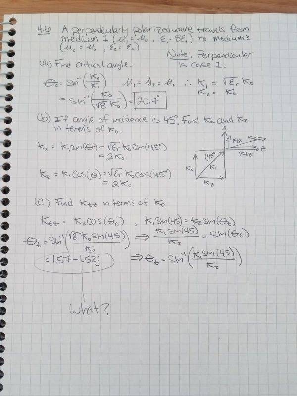

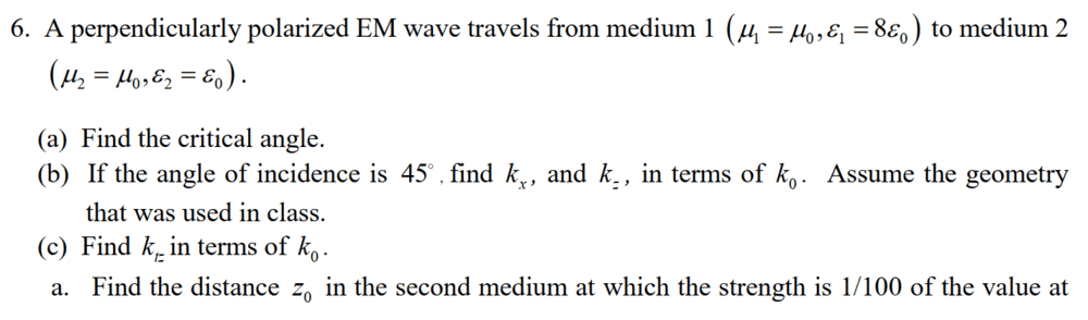

The discussion centers on the interpretation of a complex transmission angle encountered in wave propagation analysis. The user expresses confusion regarding the significance of obtaining a complex number for the transmission angle in part (c) of their problem. It is clarified that when a wave transitions between different media, it can produce a surface wave characterized by a guided wave along the interface, resulting in an elliptical E field vector. The user is advised to utilize the complex number in the cosine function and incorporate the wave number K0 for further calculations.
