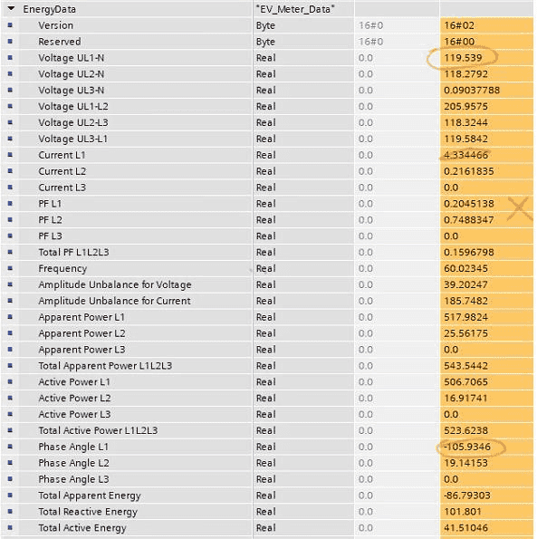

I currently have a standard meter and can only measure phase angles at individual phases. With equation above, I would need UL1-L2 to IL1 phase angle. Thus, giving another unknown.
For those who have a similar question and are simply trying to measure active power with single phase L-L 208 VAC circuit, I have confirmed that PowerLogic PM5300 will work.
Wait a minute, that makes no sense. To measure voltage, you need two points. What are the two points where your voltage leads go?
Edit: And how does your meter measure the phase? Phase relative to what?
I should of clarified. Individual phases relative to the neutral. That is, measurements between L1-N, L2-N, or L3-N in a 3 phase configuration. In such configuration, register (data tag in the meter) named "Phase Angle L1" would mean the phase shift between the current wave that's flowing between L1 and N AND the voltage wave that's between L1 and N. Most meters I've encountered only measure phase angles with respect to the neutral. Most of them can actually measure voltage between voltage phases, that is, voltage L1 to voltage L2. But they cannot measure current that's flowing from L1 to L2, thus, cannot measure power or energy or phase angles. For that you would need a meter that's capable of such measurement, such as one mentioned above. So that the phase angle of two waves can be measured: voltage wave between L1 and L2 versus current wave between L1 and L2.
I was wondering if there was a way to derive, mathematically, that phase angle (or current) between L1 and L2 with values from a meter that only measures with respect to the neutral.
I'm not actually sure exactly how digital meters measure phase angles but I imagine it's similar to an oscilloscope (aka measuring instantaneous voltages and currents [not RMS]).

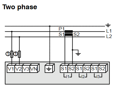

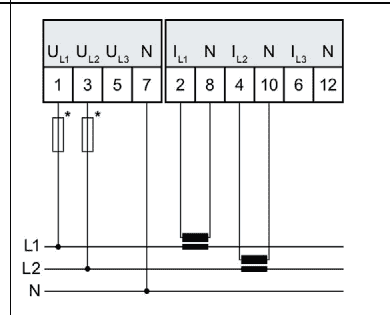

Argh - It is an Energy meter and will all of the work for you. So this is just a connection question.
The meter you referenced ( 6ES7134-6PA20-0BD0 ) is a siemens analog input module.
https://support.industry.siemens.com/cs/attachments/109481117/et200sp_ai_energymeter_480vac_st_manual_en-US_en-US.pdf?download=true
DS: https://ca-en.alliedelec.com/m/d/e079437aab96ab803936d6cfddcbd5d9.pdf
It needs to be accurate for any load connected in a 3 phase system, including single phase loads. Ideally you should have access to the Neutral, even if not connected to the load. IF you have the neutral - then you should have 3 Wires L1-L2-N - and 2 phase CTs)
Connect exactly as Fig 3.1 - just ignore the UL3 Voltage and the IL3 CT connections.IF you do not have the Neutral THEN confirm the Transformer Secondary WYE IS Grounded.
Then connect UL1 to you L1, UL2 to your L2, N to a local GND in the panel - And IL1 to CT 1 and IL2 to CT2.
IF - the trans is not grounded ( doubtful) OR you do not have a solid panel ground ( sorry but for lask of a better term "what the..." ) - then you need a different meter - or contact Siemens for their blessing.
I would not connect a leg of 208 to the N terminal becasue I do not know if the Neutral terminal can support the voltage relative to GND. Actually this would be a very bad idea to do anyway- as terminals marked N should not be energized (it is an operational safety hazard to service personnel)
As for your PHASE ANGLE questions - is a generic term referencing ANY two inputs, so yes, it will apply between voltages, and voltages vs currents, etc. But in this case with this meter - you do not need to deal with that.

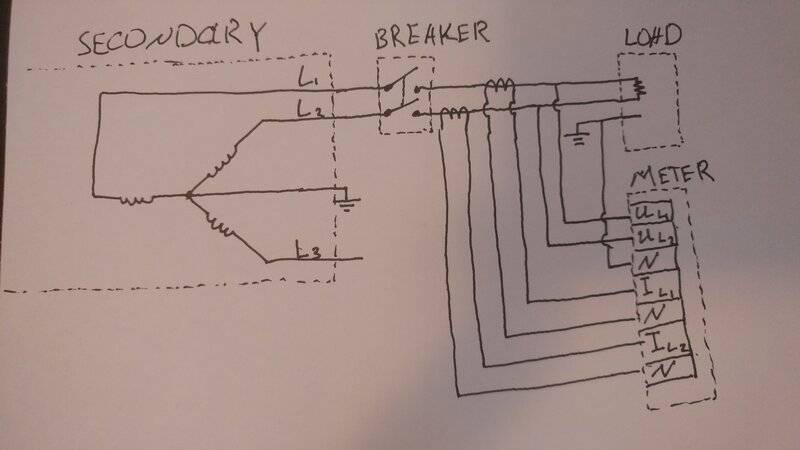

Good afternoon,
It is currently connected as you've descripted. Yes, secondary of wye is grounded as well. The problem is that in such wiring configuration with this particular meter, meter measures power and energy with respect to the neutral. For example, register that reads "Apparent Power L1" is a result of a multiplication of current on L1 and the voltage difference between L1 and N (120VAC).
The goal/question is to determine/calculate active power (I mentioned phase angle earlier because I think phase angle needs to be determined first) between L1 and L2.
Earlier, I was questioning if connecting L2 to N would work and came to the same realization, potential internal shorts may occur resulting a safety hazard. Thank you for confirming.

It seems all of your questions are in the ET 200SP Manual that I linked to.
The connection diagrams ARE in there. Section 3.2
ALL of the date you are looking for IS available. Appendix B
Yes power is reported per phase - but also total.
It is doing everything you need.

None of the connection diagrams fit the actual circuit. I have reviewed the manual several times now.
Total power is calculated by adding individual phases in three phase configuration (meter setting).
For example (I actually need active power, but using apparent power for the example since it's very easy to calculate yourself):
---- Meter Calculation (3 phase config)----
L1 power: 120VAC * 1Amp = 120 VA
L2 power: 120VAC * 1Amp = 120 VA
L3 power: 0VAC * 0 Amps = 0 VA
Total power: 120VA + 120VA + 0VA = 240 VA
*This could also be 0 VA depending on how CT is wired.
---- Hand Calculation (1 phase)----
L1 to L2 Voltage: 208 VAC
Current: 1Amp
Total power: 208 VAC*1Amp = 208 VA
You can see that two calculations above don't match, meter calculation is not correct. Since apparent power isn't correct, active power won't be either.
This meter (and others that I've referenced earlier) does not support single phase L-L configuration.
The only single phase configuration that it supports is L-N, and as mentioned before wiring second L to N is not a good idea.
So, besides getting a new meter, I was wondering if there is a way to calculate active power for single phase L-L configuration by using data provided by three phase configuration (such as inflow/outflow energies, phase angles, frequencies, PFs, etc.).
I hope this clarifies my question. Thank you.

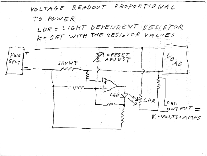

If you don't mind a DIY project, see this for a DC version of a power meter.
https://www.physicsforums.com/posts/5890314
It would be modifiable to AC by biasing the op amp appropriately. You will probably want to use a Current Transformer instead of the Shunt that is shown, also the voltage input would need a step down transformer.
It would be modifiable to AC by biasing the op amp appropriately. You will probably want to use a Current Transformer instead of the Shunt that is shown, also the voltage input would need a step down transformer.View attachment 285487
Cheers,
Tom
Perfect, thank you Tom.
Would you happen to know how active power is determined?
For the circuit as drawn, it is an inherent characteristic assuming that the frequency response is flat & phase shift is negligible at all frequencies of interest.
The output is proportional to the brightness of the LED multiplied by the voltage applied to the LDR.
You will have to calibrate the circuit. There is a non-linearity of the LED, especially at lower currents (it is super-linear, i.e. more sensitive to current variation at low levels, below 20% of rated current); and don't forget they need a few volts to turn on.
The LDR resistance curve flattens at high illumination, which may or may not be a problem. You could just use the datasheet values, but is probably easier to calibrate with resistive loads.
You will also need to account/compensate for phase shifts in any current or voltage transformers you decide to use. Probably best to avoid transformers if you can, but that means the circuit is at line voltage, which could make things difficult. Perhaps connect an Optical Coupler to the output (look for techniques to linearize them, I seem to recall a single-OpAmp circuit).
Cheers,
Tom

Thanks for mentioning that, did some more research. In a three phase configuration, that makes sense. Summing up instantaneous currents of a three phase balanced load will result in 0, thus, no need for the neutral. However, things change when you have an unbalanced load and you would then need a neutral. This would also be true when only 2 phases are wired. So the meter would assume that the rest of the current is going through the neutral. Total power would be a result of calculated power summation of two phases with respect to the neutral. This, of course, would give a higher final result (as shown earlier) than what it actually is when single phase L-L is used. This is also what I'm seeing when reading the data. This is my attempt at understanding field results, is there a reason why it wouldn't be used on an unbalanced load?
I don't see why such completed meters wouldn't be able to measure single phase L-L. I might be missing a setting but I also don't see anything in the data tables that would suggest such measurement/calculation is made.
You will have to calibrate the circuit. There is a non-linearity of the LED, especially at lower currents (it is super-linear, i.e. more sensitive to current variation at low levels, below 20% of rated current). The LDR resistance curve flattens at high illumination. You could just use the datasheet values, but is probably easier to calibrate with resistive loads.
Would calibration with the resistive loads account for the phase shift? I suppose not if transformers are part of the calibration circuit.
This is not true. 3 phase delta connected secondaries can have a different load on each phase with no neutral required.
The issue here is yu need to see the vector relationship of the two phases - you can not just ADD apparent power like that, sorry that is just not how it works.
The 1 A you show as L-N is not the same phase angle as L-L.
The wiring of the meter - and the specific connection of the Voltages and the CTs - sets an expected phase shift between the measurements.
In a meter set up with Phase CTs ( current) and L-N Voltages the calculation per phase has no phase shift due to the connections - BUT when you look at Phase to Phase (L-L) voltages vs the Phase CT - there is a 30 Degree shift in the SENSING - that the meter accounts for.
I am quite sure if you look at REAL power (active) using data from the meter - they WILL sum properly.
