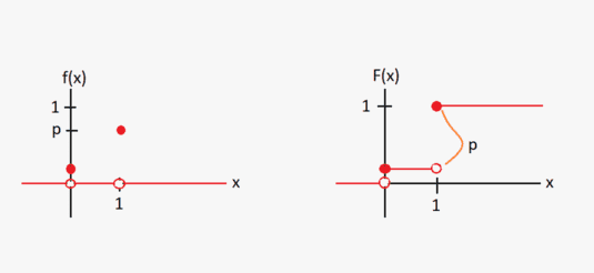

I worked something out with:
##f_X(x)=\begin{cases}
1-p,\text{ if } x=0\\
p, \text{ if } x=1\\
0, \text{ if otherwise} \end{cases}##
and got:
##F_X(x)=\begin{cases} 0,\text{ if } x<0\\
1-p,\text{ if } 0\leq x < 1\\
1, \text{ if } x\geq 1\end{cases}##
I drew a picture...
Two graphs: left, f(x) against x with points at (0, p) and (1, p), plus open circles at (0,0) and (1,0) on the axis; right, the cumulative F(x) with a jump at x = 0 to level p and a curve labelled p near x = 1.
Basically, if I derived this CDF correctly, then ##\lim_{\delta \rightarrow 0^+}F(c+\delta)= \lim_{\delta \rightarrow 0^-}F(c+\delta)+P(X=c)##. So ##\lim_{\delta \rightarrow 0^+}F(c+\delta)=\lim_{\delta \rightarrow 0^-}F(c+\delta)+P(X=c)>\lim_{\delta \rightarrow 0^-}F(c+\delta)##, and so they're not equal; continuity fails to hold at ##x=c##, as a result. I'm not sure if I'm allowed to state that a jump discontinuity of size ##P(X=c)## is there, though. I know it's there for a Bernoulli distribution, but I'm worried that I may have to show that a gap of this size actually exists for general discontinuous distribution functions.

I drew a picture...
I liked the picture here. Bernouli's are instructive. You can now apply this for ##P(X=c)=\alpha>0##. To do it directly: you can re-run the same argument showing that a continuity argument breaks on more general cdf's -- i.e. you cannot find a satisfactory neighborhood of ##\delta \gt 0## at point ##c## when someone selects ##\epsilon\gt 0## that is sufficiently small (how small? relate it to ##\alpha## in some way)
