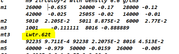

What does the number 0.62 in MCNP refer to?

Aly_19f
What does the number 0.62 refer to?
Does it the water density at high temperature?
Hi,
it is the name of the library,
lwtr.62t is a S(a,b) library for Hydrogen in Light Water :
endf 6.3 ; 500 K
To find a list of materials and temperatures, you need to look in "Appendix G" of the MCNP manual for the version of the code you are using.
I don't know what version of the code you are using, but lwtr.62t is from ENDF/B 6.3 (1993).
This is pretty old, I would use version 7 or possibly 8.
Looking at an older version of "Appendix G", lwtr.62t refers to 600 K
https://mcnp.lanl.gov/pdf_files/la-ur-03-1987g_sab.pdf
Looking at the version of Appendix G distributed with my version (LA-UR-17-20709), lwtr.62 refers to 500 K.
You need to look at the documentation distributed with your library.
