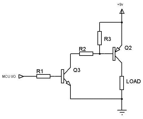

Yeah, the MCU just controls a pull-down transistor that activates the high-side switch transistor. Something like this:
https://i.stack.imgur.com/jomG1.jpg

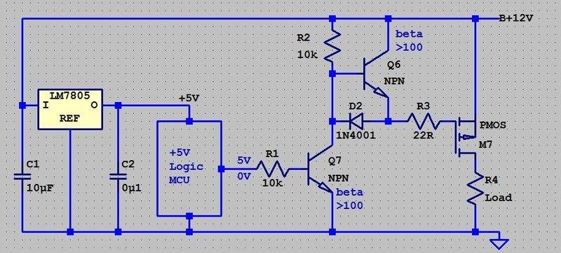

This is roughly the schematic I'm following, though I'll be using a 4 channel optocoupler to save some space, and resistor arrays.. At least for Version 1, it'll all be through-hole...
Since the Power side is only 12 V - I would say even a darlington may work here. The main purpose of an opto, IMO, is to provide good isolation between the two parts ( control and power for example) - if you were switching mains, or a high voltage then the opto. ( Also allows the voltage offset to the gate, but for a single battery driven point that is not much of an issue)
Here I do not think the opto is NEEDED - but, for the sake of learning the application of the opto, really no harm in it.

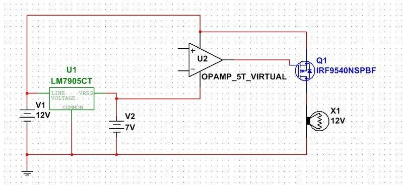

Just to be clear, you're saying you'd use a floating ground (about 7V for a 12V system) for the 5V MCU ground, so that the +5V rail of the logic is at 12V? A bit like this.. V2 is a battery in this case which was just for simulation purposes since the regulator doesn't have a model.. the Op amp would be an MCU
It was not my recommendation, but you could do that, if you get the -9V regulator the right way down. Gate drive current may need to be increased somehow.
I was suggesting eliminating the LED current and increasing the drive to the capacitive gate.
Attached is a clever and flexible circuit with very low parts cost. It provides at least 50mA drive to the gate so it switches fast. The driver here uses only 1.7mA when on, none when off. The collector of Q7 isolates the logic level from the +12V power rail voltage. The logic signal is loaded only by the 10k resistor so the logic output only needs to supply 0.45mA to Q7 base.
In an SMD format or with only a couple channels, I think that would work nicely, I'm attempting to fit this into a pretty small box with a number of channels.. and self-etched PCB's at least for V1.0 beta
What does R3 do here? Hardly seems necessary, and perhaps counterproductive to fast switching times, but I am unenlightened (unlearned).
There are two reasons for R3.
1. Some MOSFETs will oscillate at an ultrasonic frequency during the transition. A gate resistance of maybe 10 ohms will be sufficient to prevent that oscillation.
2. The gate capacitance will take time to charge and discharge. R3 protects the two NPN transistors and the diode from over-current if the transistor beta is too high.
