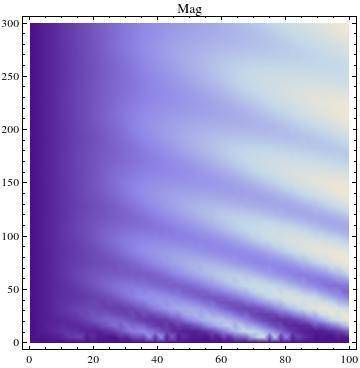

Hi folks,
So everyone at some point studying QM deals with reflections from 1D finite potential wells using the TISE, but something that I never covered was how to talk about or calculate the forces involved in turning around that particle. I tried to work something out below, but I'm not sure if it's a valid approach and was hoping for some advice.
Consider a 1D finite potential well starting at position ##x=0##, length ##a##, and depth ##-V_0##. A particle is incident on the well from the left with energy ##E>0##. Calculate the expectation of the force on the particle in that region given a reflection coefficient ##R##.
$$V(x) = -V_0 (θ(x)-θ(x-a)) $$
$$F = -∇V$$
$$ψ_{region} = e^{i k x} + R e^{-i k x}$$
[tex] \begin{align}<br /> F &= V_0 ( δ(x)-δ(x-a)) \\<br /> <F> &= ∫_{-∞}^0 ψ^*Fψ dx \\ <br /> &= ∫_{-∞}^0 (e^{- i k x} + R e^{i k x}) V_0 ( δ(x)-δ(x-a)) (e^{i k x} + R e^{-i k x}) dx \\<br /> &\text{Expanding and noting only the unshifted delta function will survive the integral} \\<br /> & =∫_{-∞}^0 V_0 δ(x) (1 + R(e^{2i k x} + e^{-2i k x}) + R^2) dx \\<br /> & =V_0 (R+1)^2<br /> \end{align}[/tex]
If this is right, then at full reflection, can we expect a force of 4 times the potential strength, while at no reflection, the particle still experiences a force equal to the potential? Also, my dimensions seem weird here: after integrating out the delta function, I'm just left with energy, not force...right? It seems proportionally correct, but I can't figure out where am I going wrong...
I'm not sure if it's a calculation error or a conceptual misunderstanding on how to deal with finding this force.
If this is a sound line of thinking or could be massaged into one, could it also be applied to a wavefunction undergoing exponential decay as it tunnels through a finite barrier?
Thanks for the help!

1) Why does my calculation of ##\langle F \rangle## have units of ##V_0##?
2) My analysis of the limits of the force are wobbly, because I forgot that the coefficient ##R## is NOT the probability of reflection, ##|R|^2##. Therefore, the answer for ##\langle F \rangle## actually has imaginary components to it once you expand it out! For reference:
$$R = \frac{(k^2 - q^2) \sin{a q}}{2 i k q \cos{a q} + (k^2 + q^2) \sin{a q}} $$
What does it mean to have a complex valued ## \langle F \rangle## ? Are the imaginary components related to dispersion/dissapative forces or a force-phase?
Plotting it all out in normalized units with respect to the experimental variables ##{E,V_0}## provides some interesting behaviors, but I'm not sure if this is even a valid technique to begin with.
The density plot is ##| \langle F \rangle |## (lighter is larger) as ##E=[0,300]; V_0=[0,100]##;
The line plot is a normalized plot of ##|R|^2## in BLACK, ##| \langle F \rangle |## in RED, ##\Re{ \langle F \rangle }## in GREEN and ##\Im{ \langle F \rangle }## in BLUE
Can someone comment on whether or not you can actually calculate the reflection force this way, and shed some light on the result if valid?
Nevermind, I solved my questions after a discussion with a friend.
1) Units issue comes from the normalization
2) Imaginary issue comes from the fact that I forgot to take the conjugate of R
If anyone comes across this and wants a more detailed explanation, feel free to pm me
