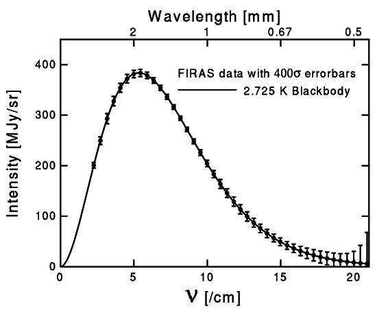

why don't we see a range of frequencies as the CMB?
We do.
@Vanadium 50 so are you saying that because of the large redshift that the EM has encountered it is all now down right next to the very limit of temp. for EM radiation?
So basically in this graph there is everything starting from what was once very hot (right after recombination) down to what was once "not that hot" long after recombination?
Would the logic go like radiation emitted long after recombination had a lower blackbody temp originally at emission so even though it was emitted later due to it's original lower frequency it now after expansion of space is right next to the radiation that was once of much higher frequency but endured a longer/higher redshift ?
You asksed why it wasn't a range of frequencies. I showed that it in fact is. No more no less.
