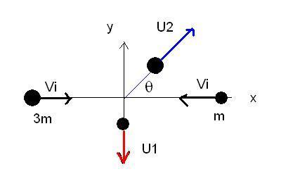

Two particles with masses m and 2m are moving toward each other along the x-axis with the same initial speeds vi. Particle m is traveling to the left, while particle 3m is traveling to the right. They undergo an elastic glancing collision such that particle m is moving downward after the collision at right angles from its initial direction.
A)Find the final speeds of the two particles.
B) What is the angle theta at which the particle 3m is scattered?
I know momentum is conserved as well as kinetic energy. I also know that i must separate the momentum before and after into i-hat and j-hat components but i just can't set up the answer. I've been going at this for quite a few hours and I just want to see how its done so i can go to bed peacefully.

Another way that may be simpler is to "play" wrt the center of mass.
Instead of fighting with formulas for hours, just make a drawing (something like the attached picture) and everything will be clear. By the way, is the mass of the second particle 2m or 3m?
You know it well, the kinetic energy is conserved and both the x and y components of the momentum. What are these components of momentum for both bodies before and after the collision in terms of the initial speed (Vi) and the final ones (U1,U2) and the angle theta?

  • Diagram of a two-particle collision with x and y axes: a 3m particle moving right at Vi on the left, and an m particle moving left at Vi on the right; after collision, U2 leaves at angle theta above the x-axis and U1 points straight down along negative y.
