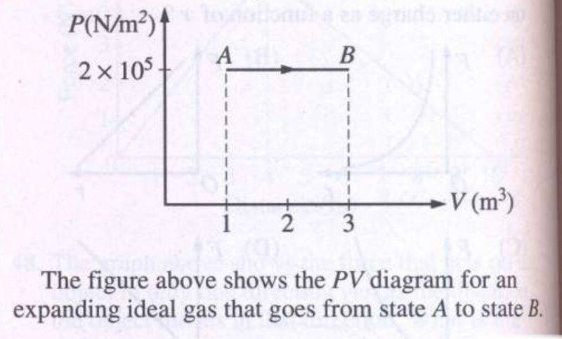

In the figure below, the volume expands while the pressure is constant. What happens when this gas expands?
A) heat is added and temperature increased
B) heat is removed and temperature decreasesd
C) heat is added and temperature decreased
D) heat is removed and temperature increased
E) heat is removed and temperature stays constant.
First law of thermodynamicsm ΔU=Q-W
Ideal Gas Law: PV=nRT
Well, as the volume increases, pressure stays the same, and the temperature also increases. Here, work is done by the gas to expand the system. So, work is positive, ΔU=Q-(+W). And since temperature increased, so does the change in internal energy of the system. Therefore, heat is added to the system.
Is my reasoning correct? That topic confuses me sometimes, so I need someone to check on my understanding. Work is done on the gas ΔU=Q-(-W). Work is done by the gas ΔU=Q-(+W). To know the temperature or the change in internal energy, use the ideal gas law. And heat depends on both of these factors, change in internal energy and work, so I can know whether heat is added or removed by knowing them.

Your reasoning is correct. You even can determine the heat added to an ideal gas. What is the internal energy in terms of temperature? Knowing the pressure and change of volume you can determine the work done by the gas. From the first law, you can determine the heat added.

According to the ideal gas law PV=nRT, P=(n/V) RT, the pressure can be constant with decreasing molecular density only with increasing temperature.
So, A is right?
YMMMA said:
So, A is right?
Yes.

Well, consider all processes reversible, slow enough, so you can define pressure and temperature during the process. The pressure is constant. You can apply the equations PV=nRT and ΔU = Q-PΔV, and if it is an ideal gas, U=nCvT, where Cv is the specific heat at constant volume. You can determine the final temperature and added heat knowing the pressure and the initial temperature, and the initial and final volumes.

This is wrong. Suppose, for example, you have a gas confined by a barrier to half of a container, and the other half of the container is empty. If you remove the barrier, the volume of the gas will double, but the temperature of the gas won't change. As @ehild has said several times, the temperature is a measure of the average (translational) kinetic energy of the particles. It has nothing to do with the density of the gas.
In this problem, the environment exerts a pressure on the gas, so for the gas to expand, it has to do work on the surroundings. If no heat is added, the energy needed comes from the kinetic energy of the particles (at least in part), reducing their average energy and therefore lowering the temperature of the gas.
