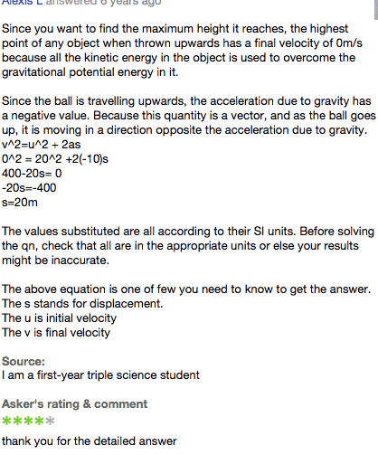

I googled questions asking for maximum height and I think this person used the SUVAT equation?

For this one I would use
V^2 = U^2 +2as
which doesn't involve time at all.
