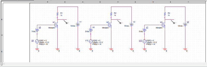

Run a transient simulation and plot the three outputs, Vo(t), on the same plot. Use the following settings:
1. Set the Run Time (or Stop Time) so that you plot 3 cycles of Vo(t).
2. Set the Maximum Step Size so that you get at least 100 points per period for Vo(t).
3. Set the Y axis limits to 0 volts and 10 volts. Do not auto scale.
The model that you will use for the MOSFET is:
Id = (kp/2)(Vgs – Vto)2 (1 + lambda*Vds)
Kp = 0.01
Vto = 1
Lambda = 0.05

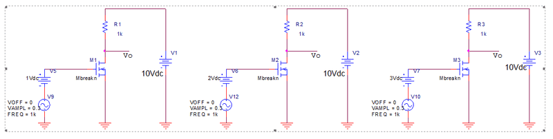

Given Circuit Design:
I have attempted to do it in PSpice but I'm getting error code saying missing values, what am I doing wrong?
My Design:

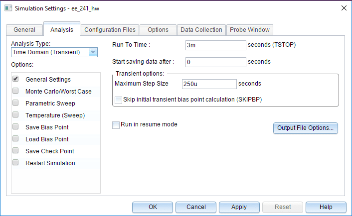

My Simulation Profile:

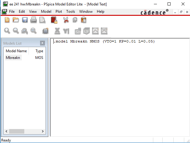

Mosfet PSpice Model:

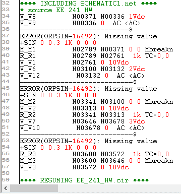

Error Code:

Welcome to the PF.
What does the manual say about that error 16492? Can you simplify the simulation down to just one circuit for now, and see if you can figure out what's missing?
