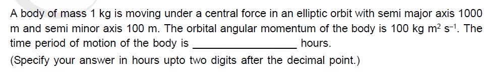

A planet of mass 1 kg is moving under a central force in an elliptic orbit with semi major axis 1000
m and semi minor axis 100 m. The orbital angular momentum of the planet is 100 kg m^2 /s. Find the time period of the motion of the planet.
T^2 = 4*(pi)^2 *(semi-major axis)^3 / GM
By using the above formula I am getting value of time-period T as 6.757*10^6 hrs.
But the answer given is 1.7 - 1.8 hrs.

Only this much is provided in the question. I have no idea how to get solution.

One piece of information you have that you haven't used yet is the angular momentum. Since you can't solve it on the basis of semimajor and semiminor axes, perhaps there's a reason there was other information given.
If you review your class notes, is it possible you may have been given a relationship between angular momentum and other quantities that might be useful here?
This is one of the IIT questions I was practicing.

So, it sounds like you want to be able to solve the problem without having studied the material, yes?
I thought this question can be solved using Kepler's laws, which I have studied.
One lesson you should learn here about Kepler's Laws is what M means in that equation. Apparently you treated it as the mass of the planet, but it is the mass of the central body. Which means that the mass of the orbiting body does not appear in the equation. All orbiting bodies of the same semi-major axis will have the same period (under the approximation that the central body has very large mass compared to the orbiting body).
This is very important.
Meanwhile, for solving this problem that means that you do not have sufficient information to apply Kepler's Third. So you need to find another equation that applies. And you also were given, as I said above, some additional information besides the orbital radius. Is it possible that additional information might be useful and another equation might be useful? What should you do when you find the initial equation you try is not useful?
There is a nifty way to approach this problem via Kepler's 2nd law (equal areas in equal times).
If you know the area contained within the elliptical orbit, which you should be able to find given that you are given both the semi-major and semi minor axes, then the period of the planet must be related to this area and the specific angular momentum (m2/s).
