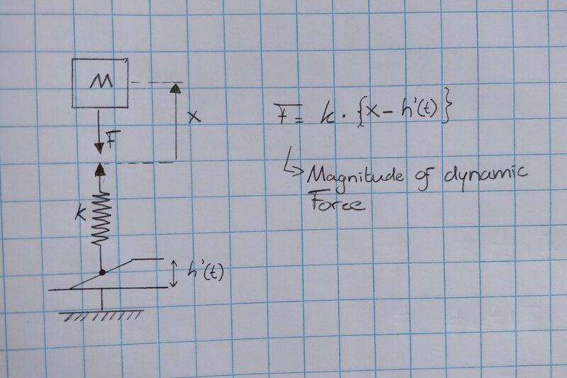

Summary:: In a mass-spring system they talk about 'magnitude of dynamic force', what is meant with that?
Hi!
In a mass-spring system I read about the term: "magnitude of dynamic force" (see sketch). What is meant with that? I the end this is used to determine the accuracy as I understand it now.
Thanks!
Is this a homework problem?

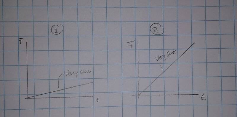

It appears that the wedge makes a sudden change to the position of the end of the spring, and you want to find the force between the spring and mass. It helps if you fully specify the problem, and say so. If so, make two hand sketches of that force vs time - one with the wedge inserted VERY slowly, and the other with the wedge inserted very fast. Does the mass bounce with one case and not the other case? Discuss, and we can help clear up any confusion.

Could you elaborate a bit more on the two hand sketches of force vs time? Do you mean something like this:

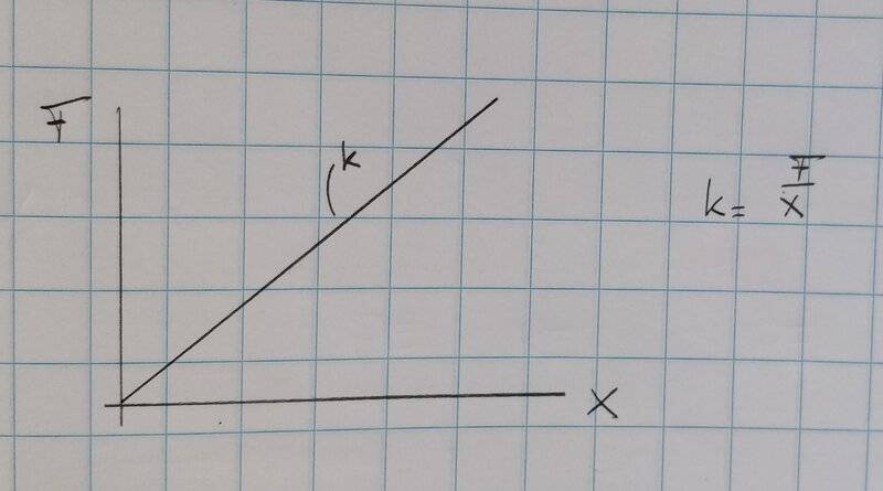

"Since the force is proportional to the length of the rubber band"
What do you mean with proportional?
It is not at all clear to me what the diagram represents. Is there any description that goes with it?
It does appear to be a generalisation of forced oscillations, i.e. where the forcing function may be aperiodic. Reading about forced oscillations would be a good start, though.
In an ideal spring, which a rubber band is not, the force (compression or tension) is proportional to the change in length from its relaxed length. That is, if you double the length change then the force doubles.
In the end it is about how the output movement varies as a function of time when an input movement is applied, in other words, to determine the response. The behaviour of the output movement (x) differs from the behavior of the input movement (h'(t)). So how great is the difference between output and input movement u= x-h'(t).
The book gives two equations:
F = m*a = m*Ẍ
F = c*(x-h'(t) --> c is k
Is this want you meant with the sketch?:
