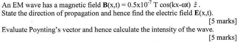

Problem:
Printed problem text: An EM wave has a magnetic field B(x,t) = 0.5x10^-7 T cos(kx-ωt) ẑ. State the direction of propagation and hence find the electric field E(x,t) [5 marks]. Evaluate Poynting's vector and hence calculate the intensity of the wave [5 marks].
Attempt:
Handwritten derivation of a plane electromagnetic wave: curl of B expanded as a determinant, leading to -dB_z/dx j = 0.5x10^-7 k sin(kx - wt) z-hat, then E = integral of c^2 (curl B) dt giving E = -(0.5x10^-7) k c^2 (-w cos(kx - wt)) = (0.5x10^-7) k c^2 cos(kx - wt) j.
I think I've done the first bit correctly (but I'm not certain). As for the second half of the question I'm at a loss. I have looked up poyntings vector and found S=ExH where H is the auxiliary magnetic field (i'm not sure what this means) and S=(1/u(0)) (ExB), but I'm not sure what to do with it.
Any help appreciated.
In free space, the auxiliary field H is just [tex]B/\mu_0[/tex]
Your answer to the first part is correct for the most part, however it is better to leave your final answer as a vector - that will help you evaluate vector cross products better. Please also check your integration step.
Wikipedia has an excellent article on the Poynting vectors, and how it is related to the intensity of the wave. You should look it up.
http://en.wikipedia.org/wiki/Poynting_vector
