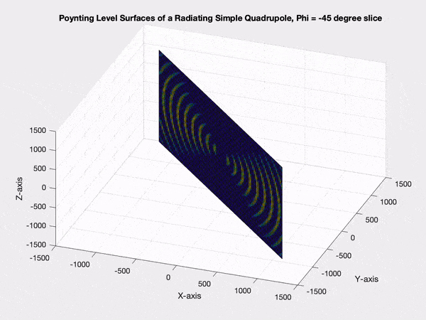

Did I inadvertently solve the octupole while trying to solve the quadrupole? I mean what is going on here.
Jackson is assuming a charge distribution with cylindrical symmetry, such as a spheroid (ellipsoid of revolution). At the beginning of the paragraph containing equation (9.50) he assumes "an oscillating spheroidal distribution of charge". Figure 9.2 refers to this case.PhDeezNutz said:@TSny I may be terribly misguided but this is what I'm thinking. If you look on page 416 (Figure 9.2) of Jackson he talks about a system that is a little bit different than the one we're dealing with but the impression I get is that each vertical plane has a quadrupole (4 lobe pattern)...
TSny said:Jackson is assuming a charge distribution with cylindrical symmetry, such as a spheroid (ellipsoid of revolution). At the beginning of the paragraph containing equation (9.50) he assumes "an oscillating spheroidal distribution of charge". Figure 9.2 refers to this case.
A "spheroid" is an ellipsoid of revolution. See here. As Jackson mentions, the nonzero components of the quadrupole moment tensor are the diagonal elements. These satisfy ##Q_{11} = Q_{22}= -\frac{1}{2}Q_{33}##. We imagine that somehow these components vary harmonically in time.PhDeezNutz said:I’m having trouble imagining what that means. Would that mean
##\rho (\vec{r}’) = \frac{3Q}{4 \pi R^3} e^{-i \omega t}##
It seems not much different than a point charge and I was under the impression that point charges don’t radiate unless accelerated.
TSny said:Yes, that looks very nice. It would be interesting to see some of the near field behavior. Good work!

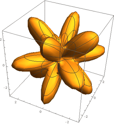

I think I may have populated the electric octupole tensor wrong because I'm getting all negatives.TSny said:Your "hand-wavy" arguments sound good to me.
I agree that there are 12 lobes. I decided to try using the approach to multipole radiation fields given in chapter 16 of Jackson's 2nd edition. I believe this material is covered in chapter 9 of Jackson's 3rd edition in a somewhat condensed form compared to the 2nd edition.
Using this approach I attempted to produce a plot showing the time-averaged power radiated in different directions. For the "cube" octupole I get the following surface. (If you pick a point on the surface, the power radiated in the direction from the origin to that point is proportional to the distance of the point from the origin.) So, the power is mostly radiated into 4 "upper" lobes, 4 "lower" lobes, and 4 "horizontal" lobes. The lobes point toward the midpoints of the edges of the cube.
There is no radiation in the 14 directions that you found. So, this seems to corroborate your results.
