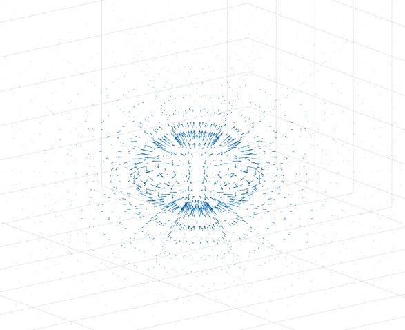

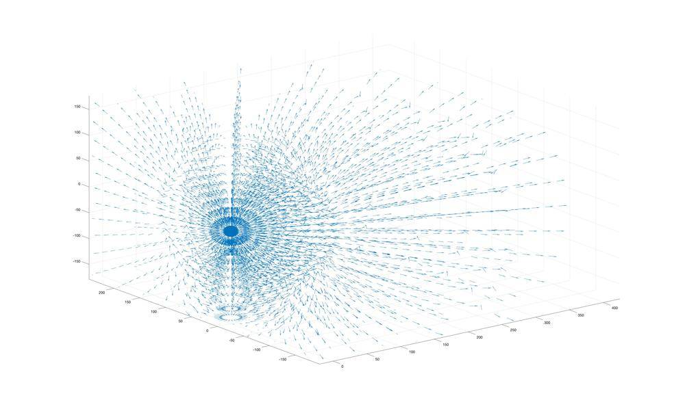

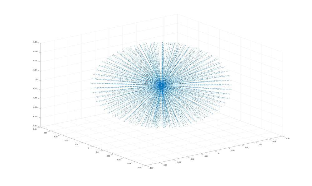

Here's a picture of my vector field at time t = 0
3D MATLAB plot of a sparse vector field, drawn as small arrows on a grid of sphere-shaped points with axes ranging from -0.6 to 0.4 in x, -0.8 to 0.2 in y, and -0.4 to 0.6 in z.
I'm very concerned about this picture because from my understanding the Poynting vector is supposed to point outwards and not loop back around, this looks nothing like the Poynting Vector field in the wikipedia .gif and I'm almost certain that I converted Jackson's formulas correctly.
The only thing I can think of is that my range of my grid is only in the "near/static zone" where maybe the Poynting Vectors do loop back around. The problem is when I expand my range the vector field is so "sparse" that it's hard to discern any salient features.
I think my problem is a problem of scale.

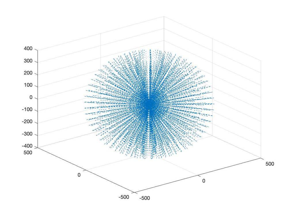

My results were not satisfactory, I'm still getting Poynting vectors circulating around the origin of the dipole instead of radiating outwards even when I expand the range to supposedly encompass the far radiation zone
Quiver plot in the x-y plane of a vector field with arrows swirling in concentric elliptical loops around the origin, dense near the centre and sparser outward, axes labelled from -1 to 1 times 10^6.
I'm guessing that this formula is wrong##\vec{S} = \frac{1}{2}Re\left(\vec{E} \times \vec{H}^{*} \right) = \frac{\mu}{2}Re\left( \vec{E} \times \vec{B}^{*}\right)##
If so what is the correct formula?
What I do find sort of comforting is that my vector field is "exactly the opposite" of what I want. If only my field was orthogonal to the one I have I'd be in a good position.

PhDeezNutz said:
I will try Re{E} x Re{H} and see what happens. Given that I plotted the time averaged Poynting vector do you find anything wrong with the fact that it’s not pointing outwards?
The time-averaged S should point radially outward in the ##\hat r## direction even in the near field region.
The instantaneous S in the near field (where r is less than roughly a wavelength) can have a negative radial component at certain times at certain points. But, for r greater than a few wavelengths, you should find that S points nearly radial at all times. In the far-field region, where r is much greater than a wavelength, only the radial component of S is significant.

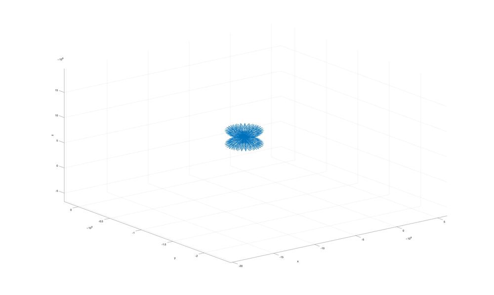

Well then there’s something wrong with my code then so I’ll have to go back to the drawing board. I have other things I need to attend to but I should be able to get back to it soon enough.
I tried ##Re(\vec{E}) X Re(\vec{H})## at ##t = 0## and got the following
3D MATLAB quiver plot of a cluster of blue arrows forming a roughly spherical, flattened burst about the origin, with axes x, y and z; the arrows are small compared with the axis range.
Some comments:
1) The"lack of coverage" is concerning. There seems to be a substantial part of the field missing, maybe when I create an animation the missing parts will fill in?
2) My dipole moment was defined to be in the z-direction and to me my picture is "off by 90 degrees"; for some reason I feel like the Poynting vectors should be coming out of the sides of the dipole instead of out of the top.

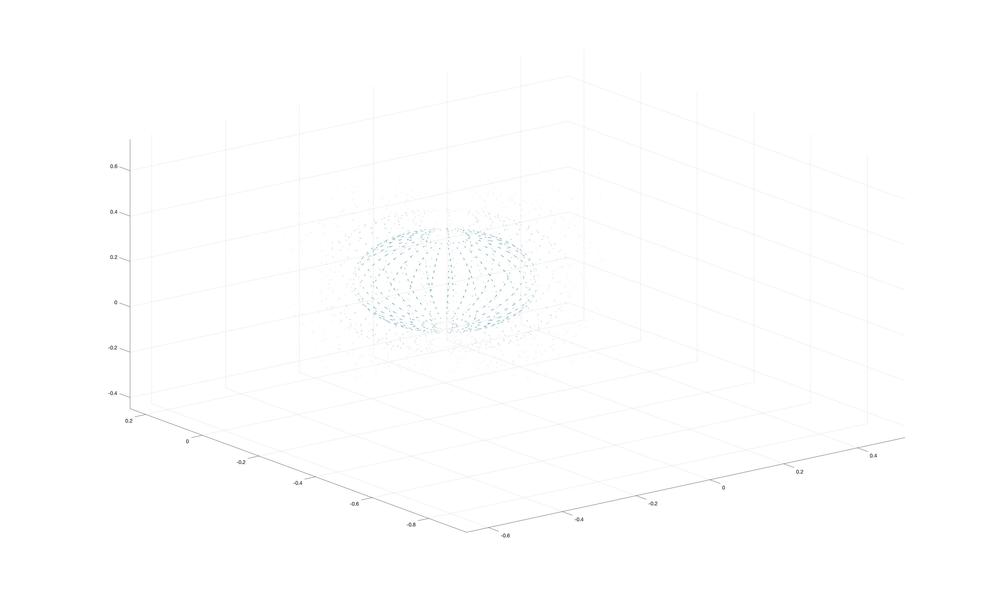

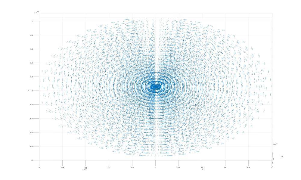

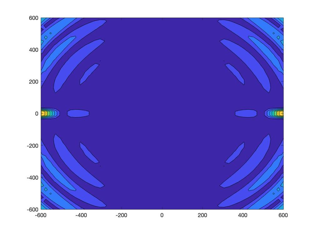

As a side note when I look at the top view of my field I get something really beautiful (yet maybe useless and wrong)
3D plot in MATLAB with axes labelled x (scaled by 10^-8 ticks from -20 to 5) and y (ticks from -2 to 0), showing a small blue radial starburst pattern near the top of a faint grid; most of the plot area is empty.
Edit: furthermore the formulas I used from Jackson are supposed to encompass both the near and far zones...I'm not seeing characteristic near zone features.

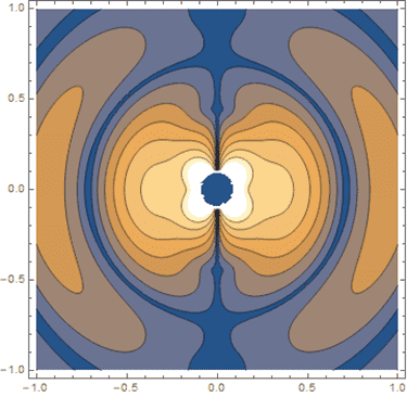

Yes, that doesn't look right. You might try a 2D plot, such as the ##\phi = 0## plane. Your expressions for the fields in your first post look correct to me (with MatLab's "elevation" angle ##\theta##).

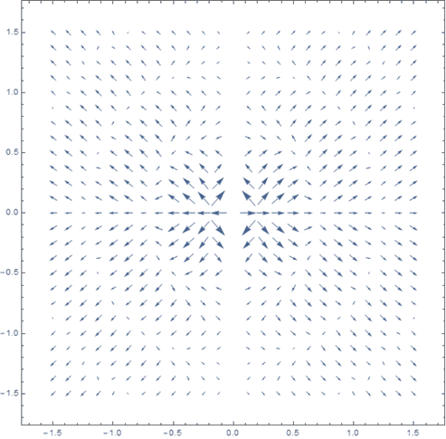

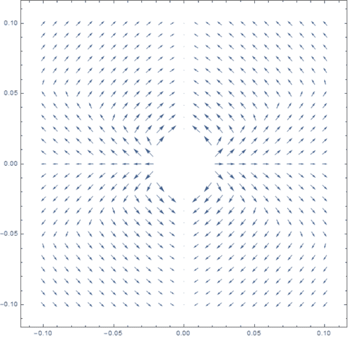

I used Mathematica to make some plots of the S-field at one instant of time (t = 0). I certainly could have made some errors in deriving the expressions for the components of S. But, these plots might give you something to compare with. I scaled the vectors in such a way that a 10-fold change in the magnitude of S changes the size of the plotted vectors by only a factor of ##10^{1/5}##. This allows for an exploration of the near field region without huge changes in the size of the vectors.
I chose ##k = 2\pi## so that the wavelength of the radiation is 1 unit. This makes the S-field have a "wavelength" of 0.5 unit.
Here is the S-field that I got for one instant of time in a region very near the dipole (out to only 0.1wavelength). I blocked out a region less than 0.02 wavelength from the dipole in order to avoid extremely large field values.
Vector field plot on axes from -0.10 to 0.10 showing small arrows that curve around a blank central region, with a horizontal line of arrows along y = 0.

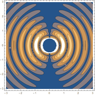

Here is a region out to about 1.5 wavelengths
Quiver plot of a vector field on a grid from -1.5 to 1.5 on both axes, with arrows swirling around the origin and two sink-like patterns near x = -0.2 and x = 0.2 on the horizontal axis.

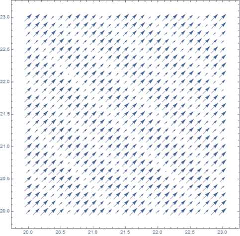

Here is a patch of area .5 < x < 2 and .5 < y < 2
Vector field plot on a grid from x = 0.5 to 2 and y = 0.5 to 2, with blue arrows of varying length and direction, mostly pointing up and to the right, with shorter arrows near the centre.
Here is a patch of "far field" where 20<x<22 and 20<y<22
Vector field plot of blue arrows on a square grid, x and y axes from 20.0 to 23.0, arrows mostly pointing up and to the right.
I don't understand your choice of the value of ##k## which makes the wavelength of the radiation equal to 400 units of distance. I believe you let ##r_{max} = 2## in your code. So, that would mean you are plotting in the extreme near field.
I actually kept the value of ##k## and ##p## the same while making ##r_{min }= 0.4## along with changing ##r_{max } = 10^{10}##
and I still don't get what I want.
Quiver plot of a vector field in the xz-plane, with short blue arrows arranged in concentric elliptical rings around the origin, denser and tangential near the centre and sparser toward the edges. Axes labelled x and z, scaled by 10^-10.
Quiver plot in the xz-plane of many blue arrows forming nested elliptical loops around a dense central cluster at the origin; arrows near the centre are dense and tangled, while outer arrows curve around the loops.
Notice that I rotated the figure to give a head on view of the ##xz-plane## i.e. (##\phi = 0##).
I'm clearly doing something wrong because I've expanded the scale well beyond a few wavelengths and I'm still not getting purely radial components.
Edit: I normalized the ##\vec{S}## vectors so that they would all show up.
Commentary: My field is almost the exact opposite of what I want; I have radial fields up close and angular fields out far...I want angular fields up close and radial fields far away.
Edit2: I feel like my field would be perfect if it was just perpendicular to the one I have.

3D quiver plot of a vector field on a faint grid, with small blue arrows arranged in a roughly spherical pattern around the center, pointing outward at the top and bottom with a dense knot of arrows near the middle.
sph2cart transforms spherical to cartesian and accepts radian arguments
sph2cartvec transforms a vector in spherical (##\hat{az}##),##\hat{el}##,##\hat{r}##) to cartesian at a given azimuth and elevation angle (in degrees)
cart2sphvec transforms a vector in cartesian basis to spherical basis at a given azimuth and elevation angle.
vertcat vertically concatenates row vectors

3D quiver plot of a field of arrows radiating outward in all directions from a central point, with axes labelled from -0.05 to 0.05 and a blank gap along the vertical centre line.
I find it comforting that there is no radiation along the axis of the dipole but I'm still not getting near field behavior
@TSny I think I got it
I changed my scale to a few wavelengths and I got near field behavior.
3D quiver plot in MATLAB of vectors radiating outward in all directions from a central point, forming a roughly spherical cloud; axes run from -500 to 500 horizontally and -400 to 400 vertically.
Notice that at certain radial distances the Poynting vectors point in the polar direction and in between those "rings" it points radially.

@TSny
I believe I messed up majorly

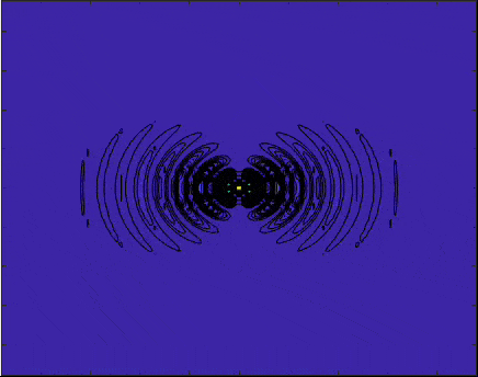

I created a contour plot in the xz-plane of the poynting vector of a radiating dipole (oscillating in the z-direction) and got something supper messed up.
To me this looks like more like a quadrupole than a dipole. How bad did I mess up?
Filled contour plot in the xz-plane, x and z axes from -600 to 600, showing intensity concentrated in four lobes near x = ±600 at z = 0 and a diagonal banded pattern in the outer corners, with a flat dark blue centre.
Are you plotting contours of the magnitude of S? You plotted out to 600 units. How many wavelengths is this?
Here's what I get at t = 0 for a distance out to 3 wavelengths from the dipole with the central-region blocked out within 1/2 wavelength. I had to do some scaling to get a decent graph.
Contour plot of a radiating dipole field in the x-y plane, showing concentric orange and grey bands with a blue central disc, axes from -3 to 3.
Here's closer to the dipole out to a distance of 1 wavelength with blocking within 0.1 wavelength
Contour plot in the x-y plane of a radiating dipole field, with filled bands in shades of orange, tan and blue, a dark blue circular blocked region at the centre, and axes from -1.0 to 1.0.
View attachment 256921Here's closer to the dipole out to a distance of 1 wavelength with blocking within 0.1 wavelength

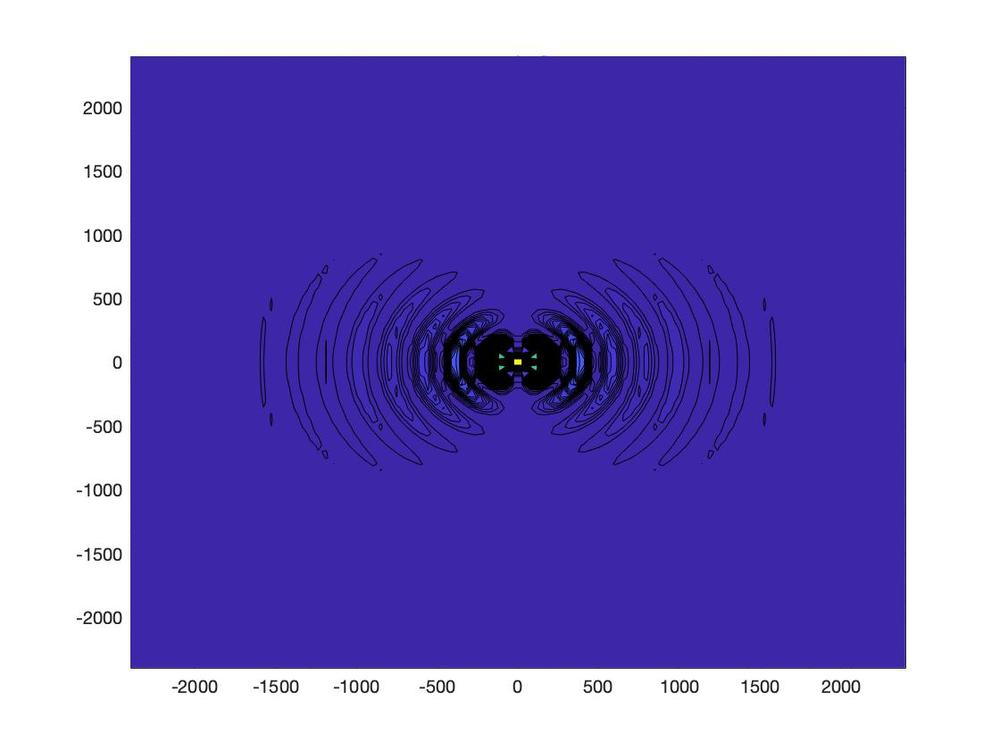

Yes I am plotting the magnitude of S.
600 is 1.5 wavelengths.since ##k = (0.001)(5)\pi##
and ##k = \frac(2 \pi}{\lambda}##
When I expand it to 2400 (6 wavelengths) and increased the number of spatial divisions by a factor of 2.
Filled contour plot of a radiation pattern on axes from -600 to 600: a blue background with nested colored bands, yellow at the center, forming a bow-tie shape with lobes to the left and right.
If anything I would think that that the contours would be "circling back to the origin".
Edit: It really feels like I inadvertently solved the quadrupole term of the magnetic vector potential.

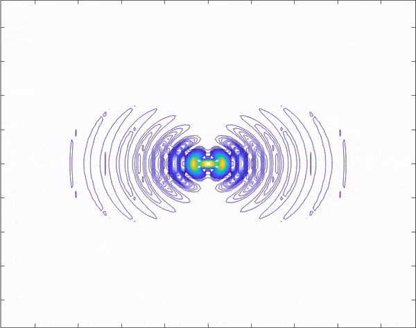

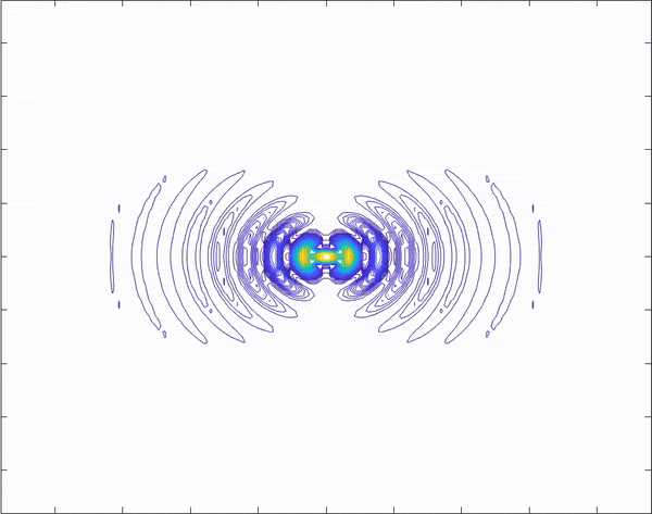

Made a gif :cool::cool::cool::cool:
I made an MPEG4 than converted to a gif using an online movie to gif converter.
Don't know what happened to my axis though.
Frame from a MATLAB plot on a blue background showing dark curved contour lines forming concentric arcs spreading left and right from a bright yellow point at the centre.
Maybe I shouldn't give myself a pat on the back just yet, maybe there's something wrong with it. @TSny how does it look? I kind of feel like the waves are shrinking into the origin instead of emanating from it.
Nice animation. The contour lines should propagate outwards. It could be that your time interval between images is too large. I don't know why some of your figures have only a few contour lines compared to some of the other figures.
Here are some figures at different times. I chose the unit of time to equal the period of oscillation of the dipole.
At a fixed location in the field, both E and B will reverse directions after half a period. So, ##S## will return to it's initial value after half a period. The spacing between peaks of the contour pattern (as shown by the red line segment in the t = 0 figure) is then half a wavelength of the radiation. You can see that the figure for t = 0.5 is the same as for the figure at t = 0. The pattern of contours is propagating outward at the rate of 1/2 wavelength per 1/2 period; i.e., at the speed of propagation of the waves of radiation.
Six contour plots in a 2x3 grid, labeled t = 0, 0.1, 0.2, 0.3, 0.4 and 0.5, showing a radiating dipole field: a central dark circle with alternating orange and blue concentric lobed bands spreading outward.

I was able to make the waves propagate outwards by changing from ##e^{i \omega t}## to the proper ##e^{-i \omega t}##
I still can’t figure out why certain frames have more contours than others. Right now I’m so desperate that I’m re-solving Jackson’s equations to confirm that they are right.
I'm fairly sure Jackson's equations are correct. I used them to get the equations for E and B in post #15 and these equations agree with what I find in a couple of other textbooks.
Then I must have interpreted them wrong/ converted them wrong. I'm glad you made this post so I don't have to start from scratch.
Contour plot of a radiating electric dipole field: blue contour lines form outward-propagating arcs on both sides, with a colored, filled central region between two lobes near the center.
updated gif with waves propagating outwards as they should. Still don't know why certain frames have more contours than others.
Edit: I think it has something to do with the default way that MATLAB sets the contour levels when I specify 100 levels. It's not that the outside is truly disappearing it's that some default threshold is set that makes the outside just "blend together" and subsequently disappear.
Yes, I think you'll get better plots if you specify particular values for the contour levels. I found that specifying 6 to 10 levels was sufficient.For example, the following worked pretty well:
(1) In the equations for the components of S given in post #15, I let ##\frac{cp^2}{4 \pi} = 1## and ##k = \omega = 2\pi##.
(2) Instead of plotting contours of ##(S_r^2 + S_\theta^2)^{1/2}##, I plotted contours of ##(S_r^2 + S_\theta^2)^{1/5}## in order to keep the far field from dying out too rapidly.
(3) I chose contour values equal to 2, 4, 6, 8, 10, 15, and 20. This seemed to work well with the choices given in (1) and (2).
(4) I plotted out to a distance of ##r = 2##.
These were just arbitrary choices. You should experiment around to see what works well.
