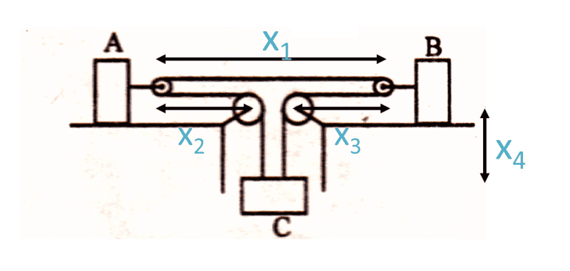

If acceleration of A is 2m/s2 to the left and acceleration of B is 1m/s2 to left, then acceleration of C is (see attachment 1)
A)1m/s2 upwards
B)1m/s2 downwards
C)2m/s2 downwards
D)2m/s2 upwards
Ans: A

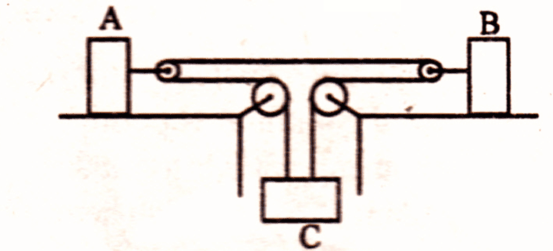

(see attachment 2, I hope the labels are clear)
Let the radius of smaller pulleys be r and that of bigger pulleys be R. I have marked the lengths of different portions of string. L is the length of total string.
[tex]L=x_1+2 \times \pi r+x_2+x_3+2\times \pi R/4+2x_4[/tex]
Differentiating twice w.r.t time
[tex]0=\ddot{x_1}+\ddot{x_2}+\ddot{x_3}+2\ddot{x_4}[/tex]
Now I am confused as to what should be the value of ##\ddot{x_1}##. :confused:
Any help is appreciated. Thanks!

I suggest expressing ##x_1## as a function of time, then differentiating twice.
Without calculus, it is not as easy. I can't think of a useful hint to give in this case except to say, use your intuition.
Hi Pranav-Arora! :smile:
Isn't x1 a function of x2 and x3 ? :wink:​
Yes but then how do I write ##x_1## in terms of ##x_2## and ##x_3##? Something like this: ##x_2+x_3+\text{some constant}##?
yes! :smile:
(what's wrong with that?? :wink:)
Okay so I get,
[tex]0=2\ddot{x_2}+2\ddot{x_3}+2\ddot{x_4}[/tex]
[tex]\ddot{x_4}=-(\ddot{x_2}+\ddot{x_3})[/tex]
##\because \ddot{x_2}=2 m/s^2## and ##x_2=\ddot{x_2}=1 m/s^2##
[tex]\ddot{x_4}=-3 m/s^2[/tex]
This is definitely wrong. :confused:

tiny-tim said:
:wink:
Can you please explain a bit more? I am still not able to understand what to do with that info. :(
so x2' = 2, and x3' = … ? :wink:
I assume you meant ##\ddot{x_3}=1 m/s^2##, but that's still wrong. Which way is B moving?
If A moves left while B is stationary, C would move up.
If B moved left while A was stationary, C would move down.
So the effects of leftward motion of A & B have opposite effects on C.
Is that a typo or are you actually asking me to calculate the first derivative? :rolleyes:
tiny-tim said:
sorry, i meant '' not '
But that still doesn't help. Both the accelerations are in the same direction. Should I work on the signs of first derivatives?
But x2 is measured to the left, and x3 is measured to the right. :smile:
So ##\ddot{x_2}=2 m/s^2## and ##\ddot{x_3}=-1 m/s^2##?
But is it wrong to think about the signs of first derivative? I never specified any directions, like you said that x2 is measured to the right.
i don't see how it helps :confused:
I never specified any directions …
yes you did! …
it's clear from your diagram that x2 and x3 are always positive, and so must be measured from the fixed end, which is in the middle
Okay, so in general, I have to specify the directions and measure distances from a fixed end. I guess I have to do some more practice on these problems. -.-'
Anyways, I get ##\ddot{x_4}=-1 m/s^2##. Do I have to put my reasoning for the negative sign like this: Since ##x_4## is positive, the negative sign indicates that the block C moves upwards. Would that be enough?
Thanks a lot tiny-tim! :smile:
It probably doesn't need any reasoning.
If you want to provide a reason, just say that x4 is decreasing, and x4 is the depth below the main level :wink:
Okay. Thanks again! :)
