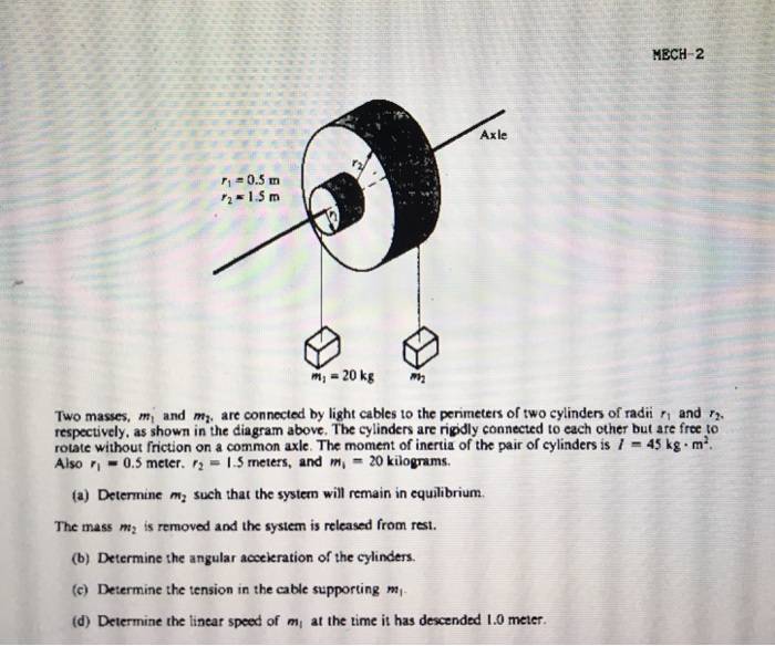

See picture.
τ[SUB]NET[/SUB] = Iα = F[SUB]NET[/SUB]r
a[SUB]T[/SUB] = rα
F = ma
PART B ONLY:
The cylinder undergoes torque when the mass m2 is removed:
τNET = Iα = FNETr
= 45α = FT(0.5)
FT = 90α, therefore msystem = 90 kg
After this step, I am not sure what to do.
τ = ΣF = Fg - Ft
= ma = (20 kg)(9.8 m/s2) - (90α)
= 196 - 90α
α = 2.17 rad/s2, which is incorrect
Can someone please help me figure out my mistake?

I meant the mass of the two cylinders combined, which I thought constituted the entire system, but now I realize I didn't factor in the hanging weight, m1. Regardless I don't think that solving for the 90α (or the mass of the entire system) is relevant to the problem.
Start over with two equations: (1) For the torque on the cylinders & (2) For the net force on the hanging mass. (Use a = rα to relate the linear acceleration in (2) to the angular acceleration in (1).)
Solve these together. I suggest doing it symbolically, only plugging in numbers at the end.
Doing it symbolically makes it more confusing for me, so I will use numbers.
Torque on cylinders:
τ = Iα = ΣFrperp.
τ = 45α = ΣF(0.5)
ΣF = 90α
Net force on hanging mass:
ΣF = Fg - Ft
= 20(9.8) - 20(a)
= 196 - 20(αr)
= 196 - 20(α(0.5))
Combine:
90α = 196 - 20(α(0.5))
100α = 196
α = 1.96 rad/s2
Thanks I got it!

The way I would do it symbolically is like so (where I use T = tension):
(1) ##Tr = I\alpha##
(2) ##mg - T = ma = mr\alpha##
Multiply (2) by r:
(2') ##mgr -Tr = mr^2\alpha##
Add (1) and (2'):
##mgr = I\alpha + mr^2\alpha##
Solve for ##\alpha##:
##\alpha = \frac{mgr}{I + mr^2}##
Now plug in the numbers!
