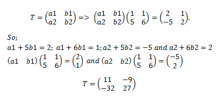

Sorry vela, I've attached my working on this msg.
Suppose you have two vectors [itex]\vec{x}, \vec{y} \in \mathbb{R}^2[/itex] such that [itex]\vec{y} = T(\vec{x})[/itex]. Then you can write
\begin{align*}
\vec{x} = x_1 \hat{e}_1 + x_2\hat{e}_2 \\
\vec{y} = y_1 \hat{e}_1 + y_2\hat{e}_2
\end{align*}where [itex]\hat{e}_1=\begin{pmatrix}1 \\ 0 \end{pmatrix}[/itex] and [itex]\hat{e}_2 = \begin{pmatrix} 0 \\ 1 \end{pmatrix}[/itex] are the standard basis vectors for [itex]\mathbb{R}^2[/itex]. When you say T has the matrix [itex]\begin{pmatrix} -2 & 1 \\ 5 & 2 \end{pmatrix}[/itex] with respect to this basis, it means that
[tex]\begin{pmatrix} y_1 \\ y_2 \end{pmatrix} = \begin{pmatrix}-2 & 1 \\ 5 & 2 \end{pmatrix} \begin{pmatrix} x_1 \\ x_2 \end{pmatrix}[/tex]
In this problem, you're given a second basis, [itex]\hat{b}_1 = \begin{pmatrix} 1 \\ 5\end{pmatrix}[/itex] and [itex]\hat{b}_2 = \begin{pmatrix} 1 \\ 6 \end{pmatrix}[/itex]. As before, you can express [itex]\vec{x}[/itex] and [itex]\vec{y}[/itex] as a linear combination of them:
\begin{align*}
\vec{x} = c_1 \hat{b}_1 + c_2 \hat{b}_2 \\
\vec{y} = d_1 \hat{b}_1 + d_2 \hat{b}_2
\end{align*}Obviously c1 and c2 aren't going to be the same numbers as x1 and x2, and d1 and d2 won't be equal to y1 and y2. However, because [itex]\vec{y} = T(\vec{x})[/itex], c1, c2, d1, and d2 will be related by a matrix equation
[tex]\begin{pmatrix} d_1 \\ d_2 \end{pmatrix} = \begin{pmatrix} a_{11} & a_{12} \\ a_{21} & a_{22} \end{pmatrix} \begin{pmatrix} c_1 \\ c_2 \end{pmatrix}[/tex]It is this matrix, [itex]\begin{pmatrix} a_{11} & a_{12} \\ a_{21} & a_{22} \end{pmatrix}[/itex], that you're looking for, the matrix of T relative to the basis B.
Now consider what happens when you choose c1=1 and c2=0. If you think about it a bit, you should be able to solve for the first column of the matrix. Conceptually, you're doing exactly the same thing you did in the previous problem.
