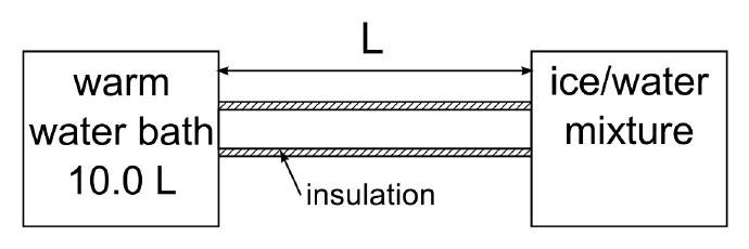

A warm water bath containing 10.0L of water is connected to an ice-water bath with a piece of metal of length L = 2.11 m and cross sectional area A = 1975 cm2. The metal has a thermal conductivity of km = 60.5 Wm-1K-1, a specific heat of cm = 239.7 Jkg-1K-1 and a density of ρm = 3782.5 kgm-3.The warm water bath is initially at a temperature of Th = 63.6 °C.

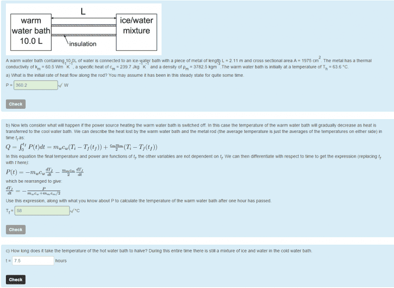

Aha, there were a few chunks from the problem statement that you left out (without malicious intent, I am sure) and indeed resolve my confusion :smile: !
And you should be able to understand the difference between the actual problem and the rendering as I quoted in post #4 ! The text is about the equation for Q you accidentally replaced by the equation for P.
It also dawns on me that, to answer (b), you effectively use the value for P at t=1 hour (the formula as found in part (a)) -- which I think is very crooked.
It only works because P is small enough. If you would have used the value for P at t=0 that would have given 57.98 degrees, which also would have been found OK by the program, I suppose.
The correct way (I think) would be to write $$
{dT(t)\over dt} = {k_m A\over L} \ {T(t) - 0 ^\circ{\rm C}\over m_wc_w + m_m c_m/2}$$giving $$
{dT(t)\over T} = {k_m A\over L} \ {1\over m_wc_w + m_m c_m/2}\; dt$$
which you can solve, I suppose.
