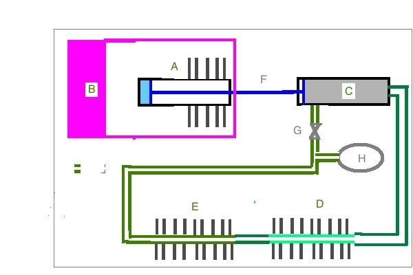

I do not necessarily disagree with all you've said. Actually, I mentioned the heat pump refrigeration as an alternative solution, which I think is more efficient than the original post using air as the refrigerant by evaporation. That I know, will not produce enough cooling and that was what I was referring to. I never discarded water evaporation as a method. It was a bit confusing though, you mentioning the 2000 KJ/Kg from evaporating water without accounting for the time it takes to do so, which is a key element there (as you know) and it looked to me that you had mentioned a number to prove the point, which was not really helping as evidence of that. That was all.
As you mentioned this is just a good discussion place where we all learn from each other.
Thanks and good luck.
  • #37
Yes. Time is relevant (i.e. the Cooling Power). I was using an intuitive appreciation and my informed / subjective experience of hand driers and wet clothing and I am 'remembering' that the cooling effect on a moderately small area with an air speed of around 1m/s is significant. The low power involved in shifting the air is a small contribution to the cooling power of the system. Imagine and compare the puny amount of friction heating that a similar amount of kinetic power could produce.
I guess the real question would be how much KE a cooling chimney could impart to the air across the evaporation surface. There must be some Heat Engine parameters in there somewhere which could give a ball-park answer..

>> Einstein–Szilard refrigerator
Checked out the wiki article on this, but I'm not quite clear: Is this the same principle used on those propane based commercial fridges we talked about? Looks like a fairly simple machine, but Ammonia, and butane... definitely excludes it from my DIY skills.>>But the "pond" is to be a heat source (we want to take heat out of it) and not a heat sink in this case.
I'm not sure how I gave you this idea, but it is incorrect. The goal is to cool a room, not the pond. Here in the high desert, we have very cold nights (and very hot days). Since the pond will be the average daily temp, this is sure to be less than the daytime air temperature, thus I was going to use it as a possible heat sink (during the day, at least). Though I suppose, thinking about it, it COULD act as a heat source(heat-reservoir actually) when compared to cold night-time air- whatever that advantage could be.
Question about the hot air chimney: While I obviously don't want to pump the hot air into the room to be cooled, I feel like this simple setup has great potential. In science class have seen suction and blowing action use "T" connectors: Where connecting the pressure differential to the two TOP ends of the T, forces air through the bottom of the T. I don't quite get why this happens (I'll guess it's faster air=>lower pressure?), but I wonder, could a T shape like this be used with the chimney setup? Such that HOT air is let out the top, to outside, while un-heated air is pushed/pulled in/out of a third opening (like the T connectors).
The 2000KJ/Kg is, I think a useful number, even if only energy, rather than power. How much water am I going to have to pump (energycost) up to the swamp cooler, in order to cool the room. e.g. If my swamp cooler is too high above the water reservoir , there will be better ways to use the power for cooling. Though that's of course the ideal scenario, and we'd like to know the over-time quantities in real life... but I also suspect these quantities will be based upon IMMEASURABLE values, like the room's heat-loss/gain rate (which will be highly dependent on temperature of the room vs. outside). I feel like the important factor to take away from the temporal consideration: we want to pass as much air as possible over the evaporation surface, as quickly as possible.

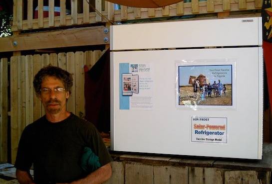

Are we talking at cross purposes here? Electrolux (afaik) are still making gas / DC / AC absorption fridges for Camper Vans and boats. There is no 'pump' in these. Absolutely no moving parts apart from the circulating fluids. They have a very low COP compared with compressor types. If you're talking about Air Con units then a fan would be needed for circulating room air. Is that the 'pump' you are referring to?
The COP of a compressor unit is so good that, even when powered from a PV panel (say 1m2, which would give you 200W), you could expect at least 1kW worth of cooling (very sloppy terminology I know) over a temperature difference of 20C

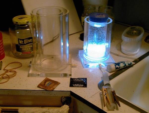

Rather than heat up some air, why not heat up some water, in the original contraption? I determined that 10 cc's of water starting @ 60°F could be turned into steam in about 7 seconds with a 2 meter parabolic reflector. @ 250°F, the steam would have a pressure of around 15 psi. I used 15 psi, as that's what most automotive cooling systems are rated at, and you can get that stuff from the junk yard for dirt cheap.
Now I also know that water at room temperature will boil when the pressure is reduced. What I did not know, is what is demonstrated in the following video, as, although I've boiled room temperature water in a hypodermic syringe before, I have never taken this experiment to this level:
https://www.youtube.com/watch?v=pOYgdQp4euc​
Those bloody brits made ice! At room temperature!
I'm going back to the drawing board. That was too cool not to research.
ps. Just ignore my first two paragraphs here. Kind of. :wink:
  • #58
My kitchen, currently, looks like Austin Power's suitcase, exploded...
Those clear tube things are Bethesda Research Lab gradient formers. I got them at surplus. They looked like they would make perfect vacuum chambers. Which they are, if you can figure out how to seal the top openings. It took me an hour. Cellophane does not work. Condoms stretched over a 16 oz inverted plastic lid, work perfectly.
Unfortunately, the tubing is not designed for a vacuum, so I'm having difficulty continuing. My fish tank air bubbler tubing is not quite the correct diameter.
(one hour later)
Eureka! I successfully evacuated 90% of the water from the gradient former. Unfortunately, I was pumping the water from the bottom, and the temperature didn't change. Of course, after the fact, I'm pretty sure I understand why. Doh! :redface:
ps. Sorry that I'm having so much fun with this thread, but "high desert" living conditions, were exactly what I was looking forward to a few months ago. And I worked out solutions to all of the problems. Zero local water, high daytime temps, freezing cold nighttime temps, living in a cardboard box like structure. Fortunately, all the tickets for Burning Man sold out too quickly. I now have 14 months, to figure this out.
The only problem I couldn't figure out, was how to survive, amongst 70,000 crazy people. Ahhhhhh!
  • #59
