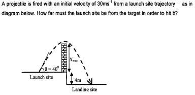

Hey, thanks for the explanation...I understand it a bit better! I see from your title that you're all into physics, so can you tell me if I have the right end of the stick with this:
Y=30 sin 40=19.28m
X=30 cos 40=22.98
Displacement in the X-direction:
x=volt+ 0.5 at^2, a=o, so cancel out (0.5 at)
x=volt
x= (22.98) (t)
Need to find time when Y=-4, taking up as positive:
Y=volt-0.5gt^2
-4=30(t)-0.5(8.314)(t^2)(multiply both sides by half)
-8=30t-8.314t^2
8+30t=8.314t^2 (t cancels out)
8+30=8.314t
38/8.314=t, t = 4.57
FIND X WHEN t=-4:
x=volt= (22.98)(4.57)
x=105.02m
Therefore the launch site needs to be 105.02m away from the target in order to hit it.
Does this seem correct to you?
1) I hope that by Y and X you mean velocity along Y direction and velocity along X direction respectively.
2) The value of g on the Earth's surface is approximately taken as 9.8m/s^2. So unless you're shooting in some other celestial body...
3)
Tut,tut... you need to use the vertical component of the velocity.
(t cancels out)
No it doesn't. Look again.
Once you find t after solving the quadratic equation, you may proceed as you have done.
You can say that the target has to be so much distance away from the launch site, which would have been all that is required if it hadn't been for that pesky wall. So use the fact that the projectile reaches maximum height just at the top of the wall, and see if you can find how far the launch site should be from the wall.
Cheers
y=30sin 40= 19.28m
y=volt+0.5at^2
-4=19.28t-.5(9.8)t^2
-9.8t^2+19.28t+8=0
(a) (b) (c)
Use quadratic formula [- b +/- sqrt (b^2-4ac)] / 2a
[-19.28 +/- sqrt (19.28^2-4 (-9.8)(8)]/2(-9.8)]
and so on forth, until t is found to equal -0.3519 and 2.319. T must be positive!
Therefore, we take 2.319 as t and input into dx=volt.
dx=30(2.319)=69.56
