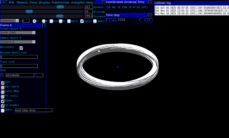

You can try it here in a simulation:
http://orbitsimulator.com/gravitySimulatorCloud/simulations/1452313177243_lunarNodePeri.html
Press the Play button [>] on the "Time Step" interface to begin the simulation. Then you can watch the Moon orbit the Earth under the influences of the Sun and planets.
In the box labeled "Collision Log" it is recording the Moon's Longitude of ascending node and argument of perigee once per lunar orbit. Let it run for 19 years, pause the Sim, and copy this data and paste it into a spreadsheet. Then you can graph it, and you can clearly see the 18-year period of the LAN and the 9-year period of the peri.
Afterwards, refresh the Sim. Press E on your keyboard to edit objects. Set the mass of all the planets (except Earth and Moon) to 0 and repeat. You will likely see that the graphs are virtually identical. Hence the planets don't contribute much.
Finally, refresh the Sim, Press E to edit, and set the mass of the planets (except Earth and Moon) AND the Sun to 0. You will likely see no change at all in the Moon's elements.
You can also try changing the mass of the Moon to see what effect, if any, that has.
The objects are all treated as point masses, so you can't test for the effects due to Earth's shape.

So far the test with gravity sim with J,S and V at zero mass is producing numbers identical to last digit. Which in view of relative magnitudes given by trf000 above seems a little odd.
fizzy said:
Is that available as gsim file, it's rather slow in the browser: about 1h per year :(
To do it in the Windows version, make sure you have the latest beta version available on the message board at gravitysimulator.com
Start with any sim that contains the planets and the moon.
Under the File menu, choose File > Output File...
Choose the Moon, and the desired orbital elements. Check "Create Data File" and "sample every" 2360584.6848 seconds.
Under the Integrator menu change from Euler to RK-4. Set the time step no higher than 1024.
When you run it, it will create a file with the same name as your .gsim file but with an extension of .dat or .txt.
What kind of computer and browser are you using?
The browser version should be must faster than 1h per year. I get about 15 seconds per year on my both my Windows 10 computer, and my Mac. But both these computers are very new. My 12-year old Windows XP computer does a year in about 3 minutes.
You can speed it up. I set the time step to 256, but you can increase it to 1024 and still get good results.
Also, under the "Preferences" menu, change "Do Events" to a higher number.
Both of these will cause fewer graphic updates, and your orbit might start looking like a stop sign instead of a smooth ellipse, but the data will still be good.
I'm getting differences 4 places right of the decimal.
The data for August 30, 2015 gives me Longitude of ascending nodes of:
180.86465069850223 with Jupiter, Saturn and Venus at their correct masses
180.86450990382707 with Jupiter, Saturn and Venus masses set to 0
Make sure after you set them to 0 that you also press "Apply".
Re-choose them in the dropdown list to verify that their masses are 0.
Also, make sure your browser is the active window. It doesn't give very many CPU cycles to a buried tab.

Is there a way to clear the collision log? I can "select all" but can't delete. File | Collision log seems to do nothing. I don't think this is working too well on firefox.
The other version of Gravity Simulator, the one that makes .gsim files, only runs on Windows. It is written in Visual Basic 6.0.
That's why I made the browser version. It runs on anything.
OK , I'm starting to get a first indication of this now. It seems the nodal data remains very close to the same without the planets. The circa 6mo cycle it half the draconic year ie 173.3d : the time it takes for the lunar node to coincide with the sun.
That fits the freq doubling I mentioned.
1/(1/drac-1/1) = 18.6 y
It looks like the perigee is more notably affected, though it does not look like the period has changed yet.
Thanks for the help, I think this sim is going to answer my questions.
Collision Log was designed to only let the program write to it.
But you can use Quick Help:
Close Collision Log
Use the Help menu to open "Quick Help"
This text area is user-editable.
Under the Autopilot menu, choose "per graphic update" and change the line:
Code:
txtAreaCollisionLog.value = txtAreaCollisionLog.value + UTC(elapsedTime * 1000 + startDate) + "," + L + ',' + P + String.fromCharCode(10);
to
Code:
txtAreaQuickHelp.value = txtAreaQuickHelp.value + UTC(elapsedTime * 1000 + startDate) + "," + L + ',' + P + String.fromCharCode(10);
Then it will store the data in Quick Help instead of Collision Log.

Thanks for the tips on following perihelion. I had noted your comments about using the help window.
BTW the 100y run I did with zeroed out planets produced a kind of torus. I was expecting the lunar orbit to cycle right around with precession. This is presumably viewed in a rotating frame, what is the horizontal direction that plot?
Thanks.

Regardless, if you're not comfortable with zero mass, do what you you suggested earlier... don't set the mass to 0. Set it to 1 gram... actually, why stop at 1 gram? Just set it it to 9e-99 micronanomilligrams. Then you have a non-zero number to cancel the numerator with the denominator. It will just take the program longer to get you results since it knows to ingore 0.
No, it is not a rotating frame. The program allows rotating frame, but it is not set in your starting simulation. With what period do you want it to rotate with? I can help you set this.

"No, it is not a rotating frame. The program allows rotating frame, but it is not set in your starting simulation. With what period do you want it to rotate with? I can help you set this."
I'm having trouble seeing the nodal precession. The plane of the lunar orbit rotates 360 deg in 18.61y, in the plot it just looks like a wobble not a full turn. :?
OK, I think I get it. It's looking down on the plane of the ecliptic, it's just not very clear with a 2D image with just two grey tones. Once there's five nodal periods on top of each other its not at all clear as an image. If we could rotate the view point it would probably be a lot clearer but that looses all the plotted data.
Maybe means to stock all the data points and then play with the sliders would be good for visualising this sort of thing.
