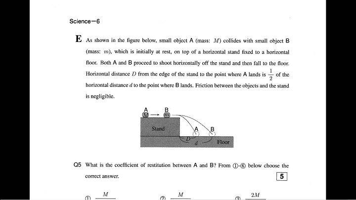

What is "coefficient of restitution between A and B" mean ?
Thank you for helping
It's the ratio of two bodies' relative speeds after they collide to what their relative speeds are before they collide. See wikipedia.
