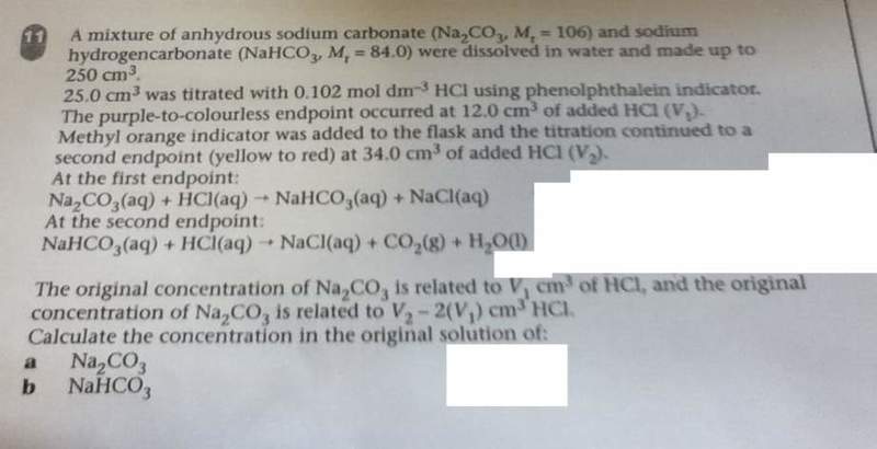

Please see the attached,this is the last question of my chemistry homework but I can't figure it out.And sorry for that I can't type any attempt at a solution because I don't understand what it is asking for.And something appears in the question like V2-2(V1) confused me.Hope someone can help or explain the question to me,thx.
Note that unit of concentration is gdm^-3
V1 and V2 are volumes of the titrant, as described in the upper part of text. V2-2V1 is just a number calculated using known volumes V1 and V2.
